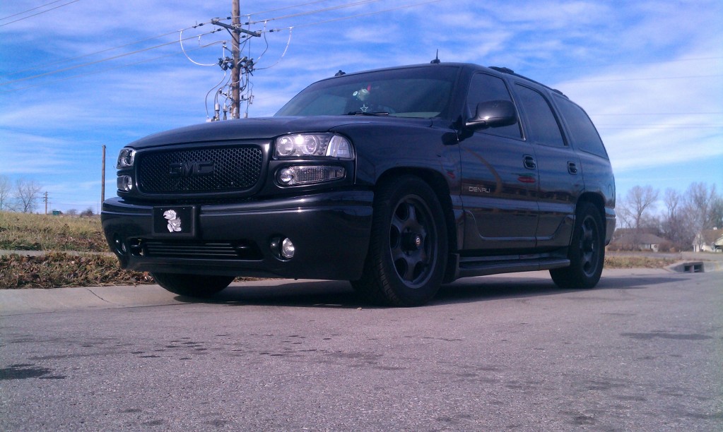

Thanks, I actaully had a 2/3 drop at one point and loved the look, (pic below) but decided I didn't have the right wheels for the setup so I decided to go up instead and got the right tires for the wheels. haha
