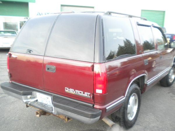

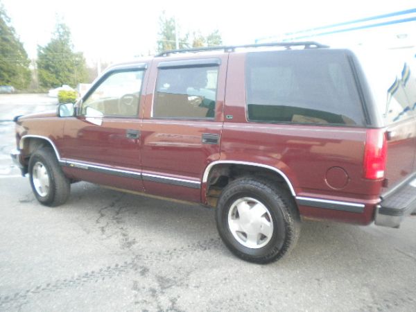

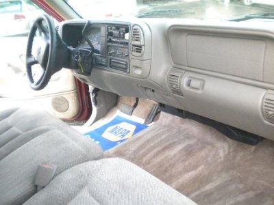

So i picked up a 98 hoe last night. Its a burgandy ls with tan cloth interior. It had the heated and power seats, and its 4x4, these were the main things i was looking for. Interior is in perfect condition i have never seen an interior this clean on an a used tahoe. Belonged to an older gentleman who drove from montana to washington. It does have 198k but does have a good service record. No leaks, he just had the valve cover gaskets replaced also the rear and front diff has new fluids along with a tranny flush. New battery and alternator etc. Anyways i could go on rambling forever but i think i got a good deal at $3000. the only thing wrong is there is a ses light on but he said that has been on for a long time and he has never got around to having it checked out or turned off, but the truck does run extremely well. Couldnt pass it up so i am bringing it home today. Gonna get it scanned and repair it to take it to emissions so i can get it all nice and ready to transfer over.

That Interior looks better than my 11' it's perfect!

Looks good you planning on a small lift? Is it floor 4x4 or button?

lol ya its push button 4x4, im not going to really wheel this thing at all. Its my daily/ pretty vehicle. I wanted it just incase i have to go over the pass and its snowing. And i will get flamed on this im more then sure, but eventually i am going for the lift with wide tires. I am from hawaii and grew up around it so i love that look. The cencal look to me is nice. I know not alot of people like it but its more of a mall crawler then anything for me and i midus well make it look the way i want.
