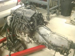

Just picked up 6.0/4L80e 2wd combo to swap into the Escahoe, just when I was about to swap in the PSC-1 with accomodating bolt ons, which is FS.
I kind of had a idea of what I am doing, figure it out as I go along. I have a 5k budget including drivetrain. Thought I could get all the bolt ons necessary (Cam,heads,Intake,Headers) before throwing FI on there. Well just a decent set of heads eats up most of the budget. So as of now all that is going on hold as do some research and look for deal$
For now my plans...
34in HD radiator with Dual Electric Fans
Hi-Flow Oil Pump
Timing Chain
Headers and exhuast
New Crank and Cam Sensor
4L80e will get a Transgo HD2 Shift Kit, new filter,gasket and stall converter
411 PCM Swap
My truck is 4wd so I am converting to 2wd.
I am Located in LI,NY. I m selling my drivetrain out of the Tahoe, PM on price. I can also install it for you as well. :)

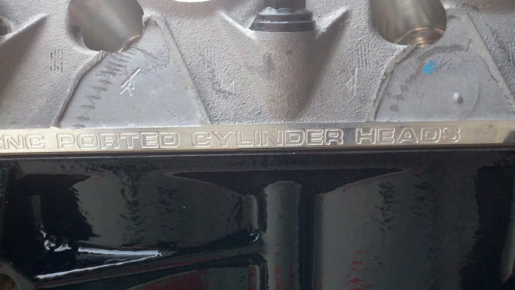

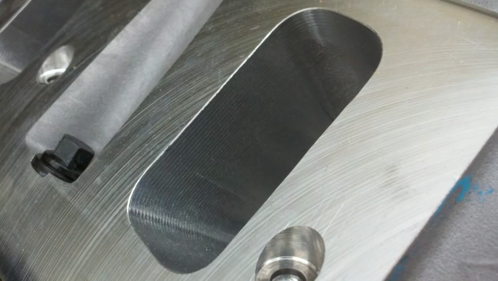

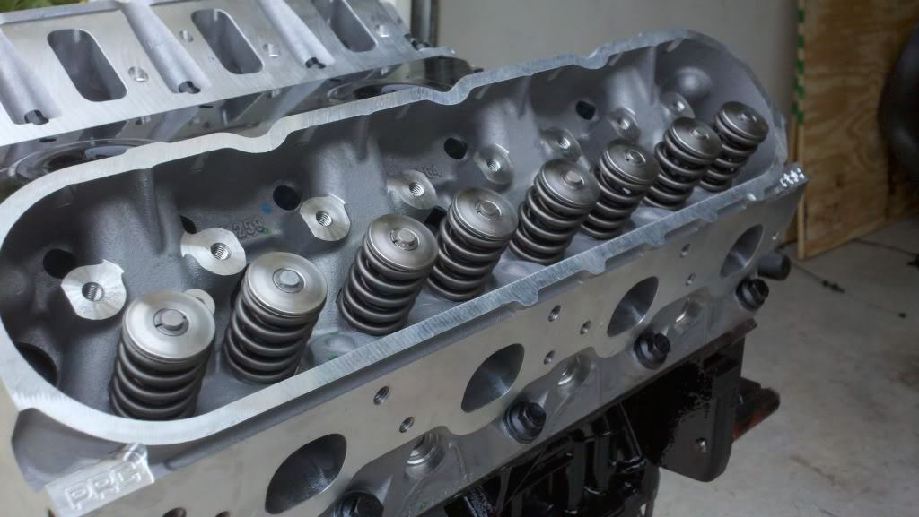

Did some shopping and some researching...before I bore you with intellect and part numbers DA NITTY GRITTY :)
I LOVE HAVING SEX BUT I RATHER GET SUM HEAD!!!!
New Precision Race Components PRC CNC LS3/L92 heads
GM Hollow stem intake valves
Factory GM 1.59 exhaust valves
PRC .650 lift Dual Spring Kit
foreverfalcon40
foreverfalcon40
May 3, 2009
2,082
I just spoke with John @ Texas Speed Performance
http://www.texas-speed.com/p-194-deluxe-heads-camshaft-bolt-gasket-kit.aspx
They answered all my questions that I had, were completely honest and talked me out of buying a few things that they deemed weren't necessary for my HP goal.
My complete gasket kit minus the EGR was around 615-620 Shipped.
I had to pull apart my heads bc there were different options in head bolts from GM.
I had Long and Short.
My Kit is all ARP even the balancer bolt. I also got a Metal Head Gasket with stock thickness. Said it is not necessary to get a thinnger gasket to make more compression.
I am ordering the rest of my goodies over the weekend. Going to start to Prep (Clean and Paint) this week. As I tear down I replace WHOOP WHOOP

Those heads are beautiful.
I am looking b/w 500-600 with Boost. Right now the engine is going in N/A. As of right now...Block will be stock for obvious reasons with the exception of LS2 Timing Chain and LS9 Cam (Boost friendly). Money is up top with a GMT900/lq9 Upper Intake Manifold Mated to a 90mm DBW Throttle Body as well as the heads.
The options are endless in LS F/I options, exspecially 2nd hand. I really am contemplating b/w S/C or turbo kit. The drivetrain must go in first, get it running properly then go for some POW POW. Honestly I think with boost I will be over my goal but thats OK :) I do miss driving my truck :(
