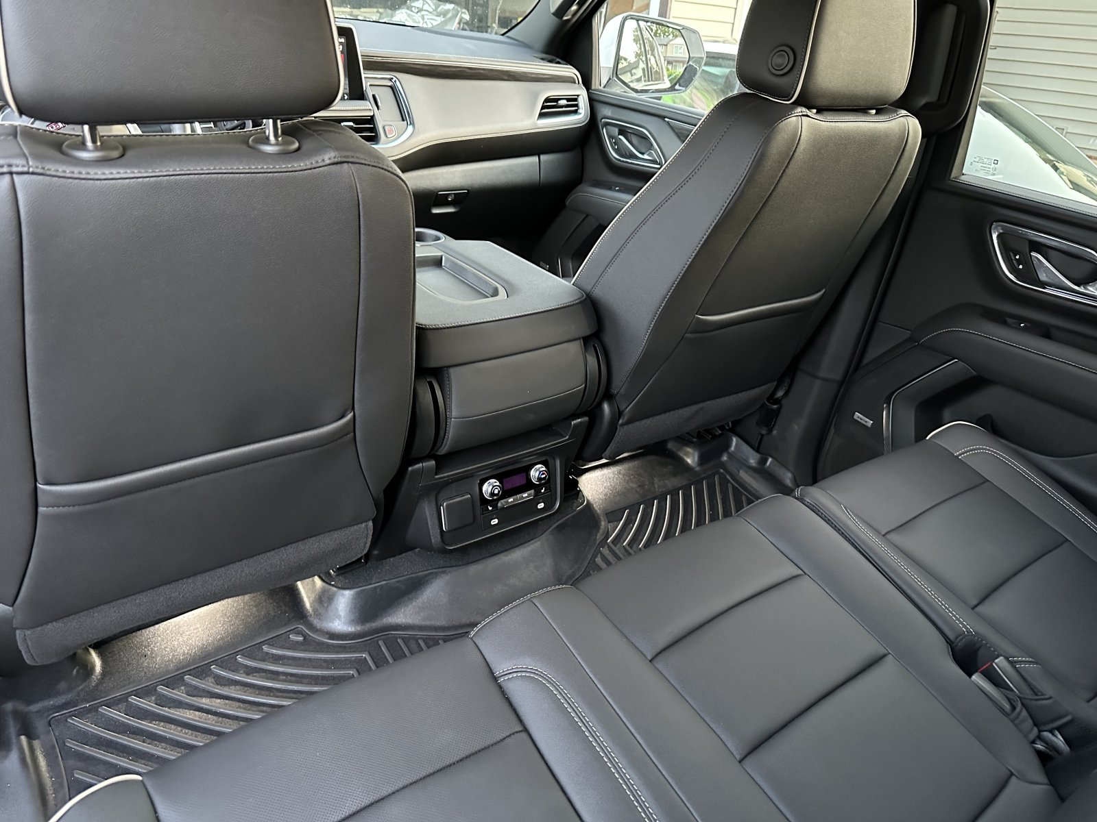

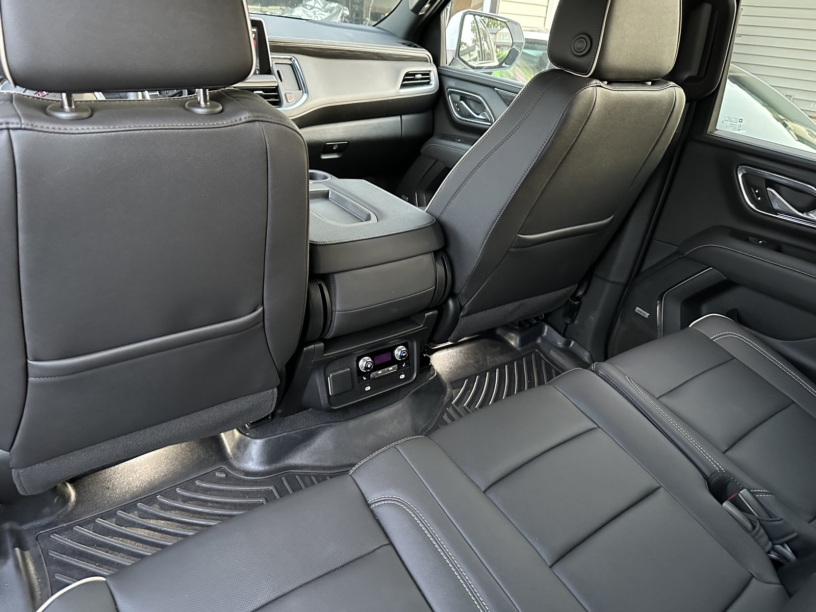

Hi there, I did.

I just came across your old post, see some pictures. It was not very easy or simple, but doable and was well worth it as I didn’t want to miss out on a lot of options/features that SLE does not offer.

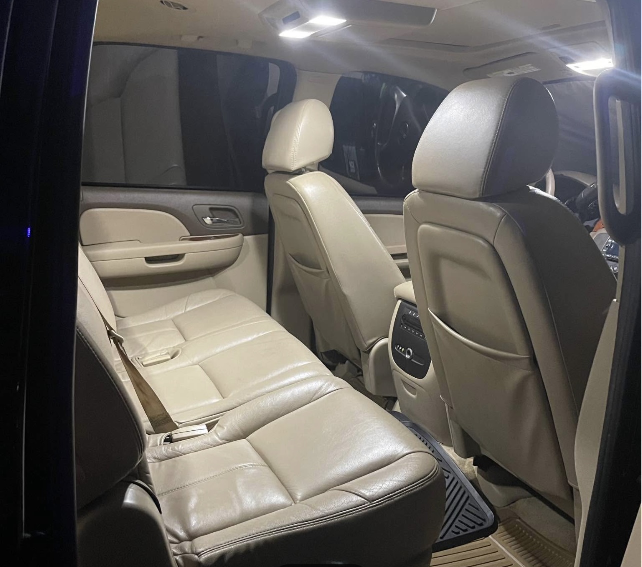

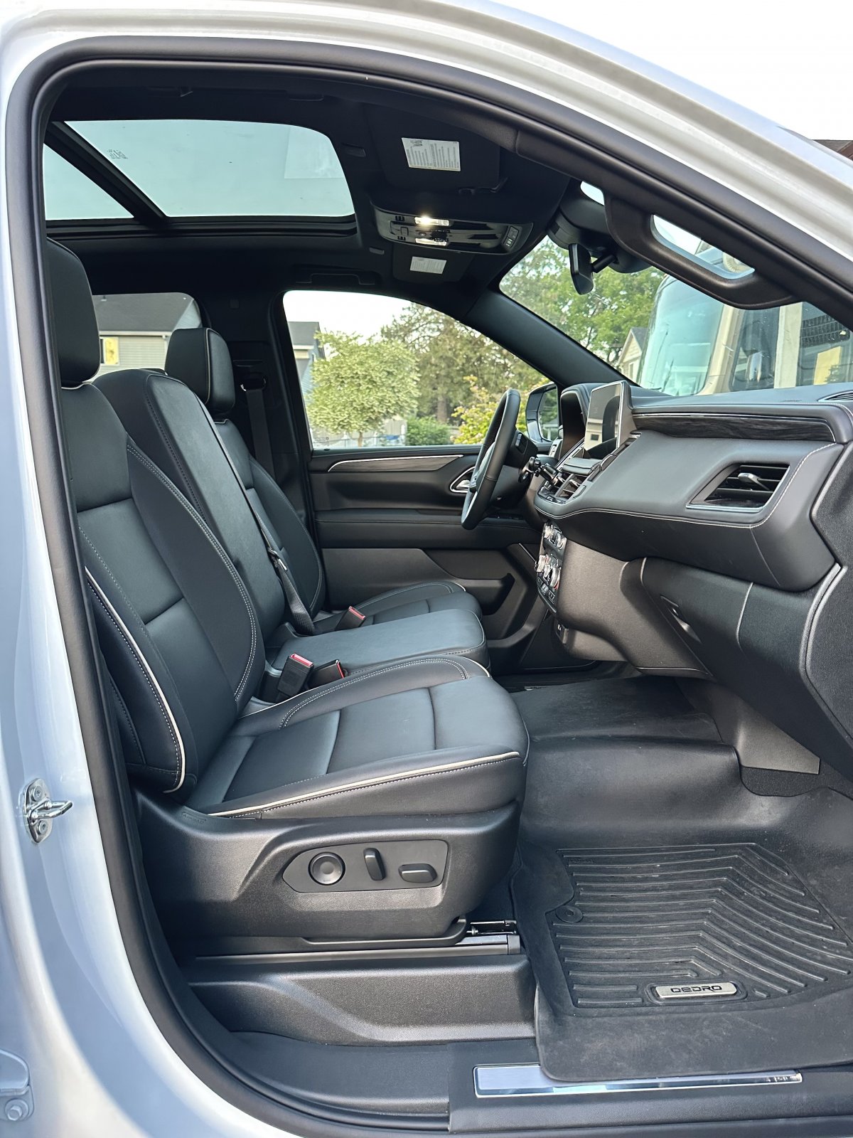

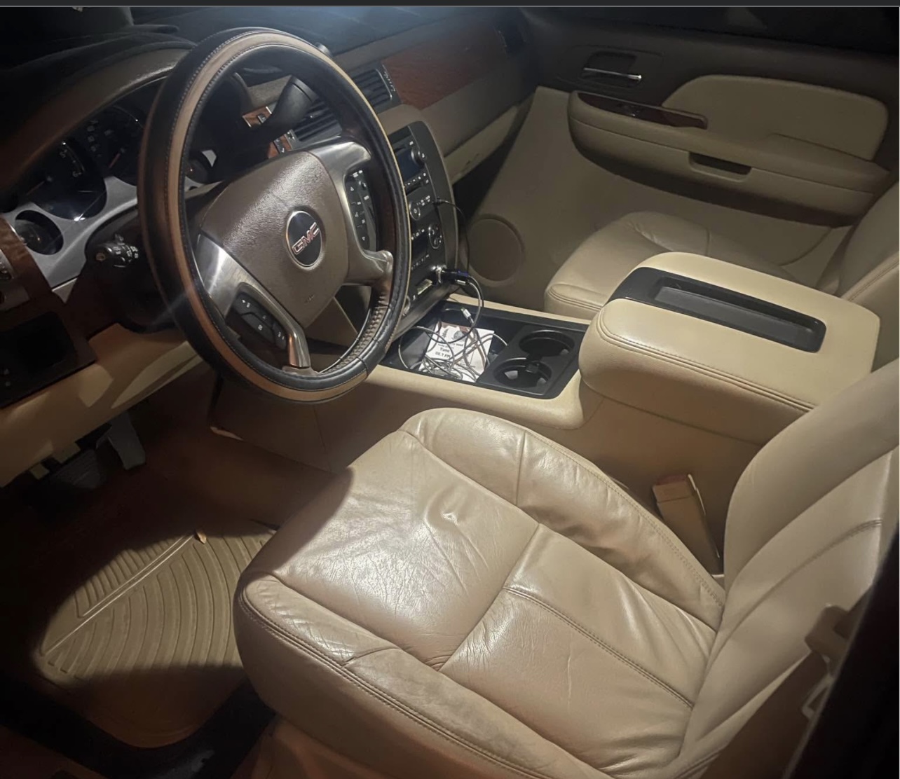

Hey what year and model did u do this one I’m looking at 2007 Yukon xl slt and would like convert to front bench so I think this possible
I did 2021-2024, 2007 will be possible, and the only issue you will have is trying to secure/place the controls from the rear of the console behind the new jump seat. On 2021-2024 the controls from the console fit right into the seat, but on 2007 it will not be a perfect fit. I think it has heated rear seat controls there and probably rear heating/ac and video input.
