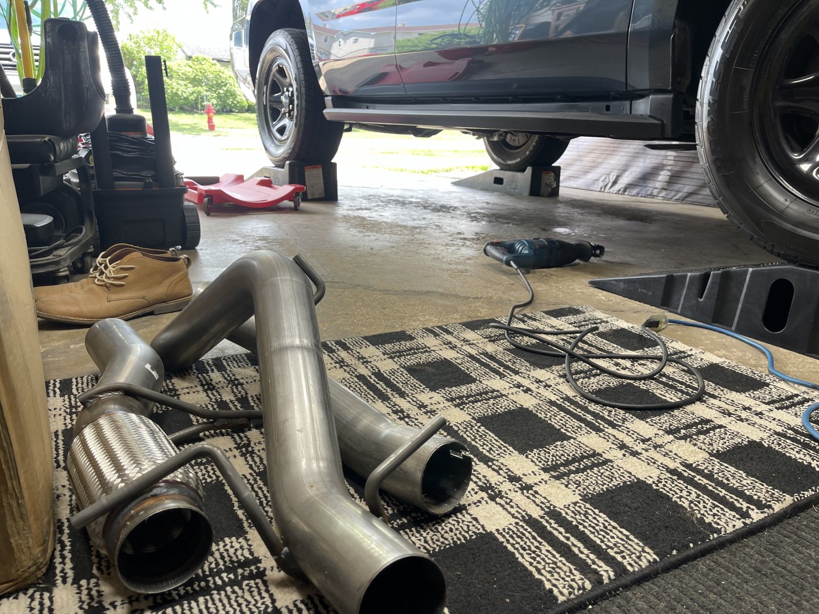

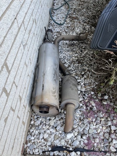

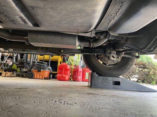

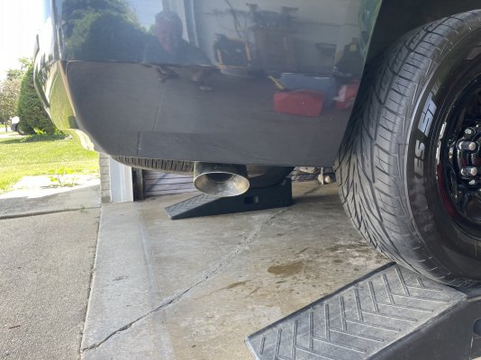

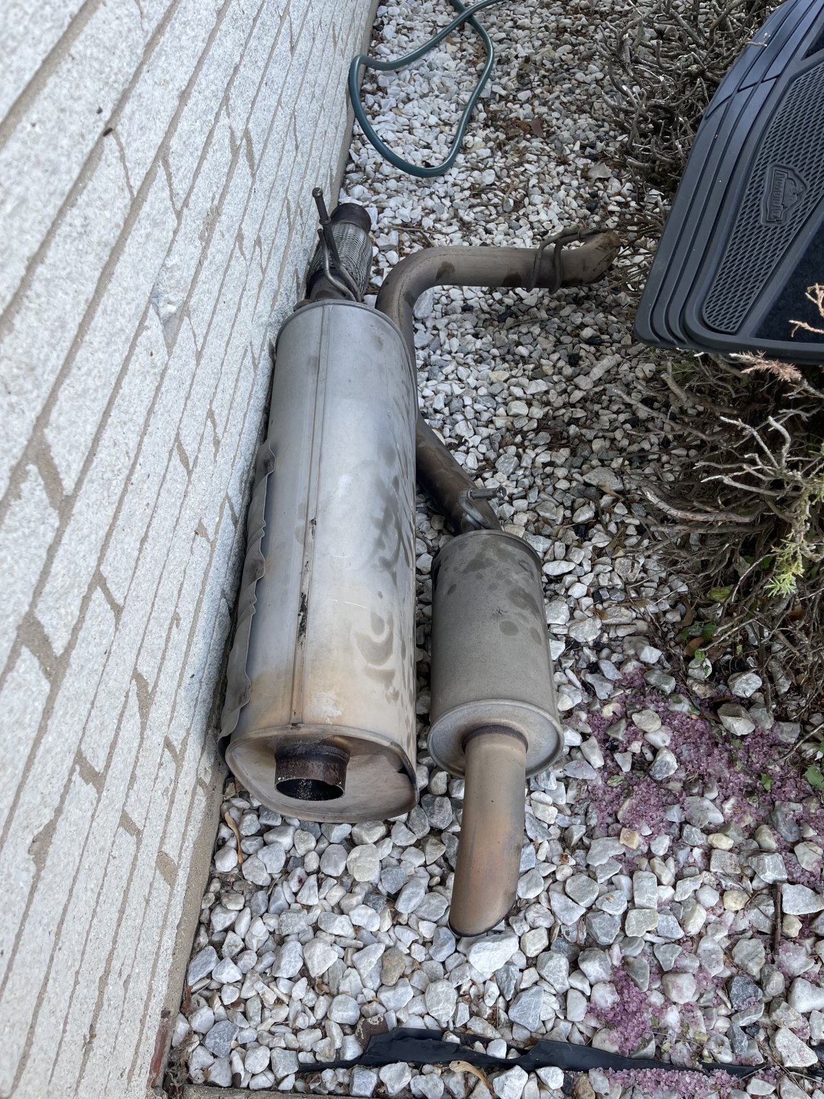

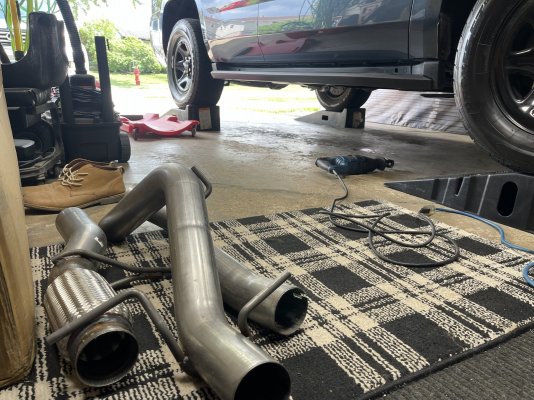

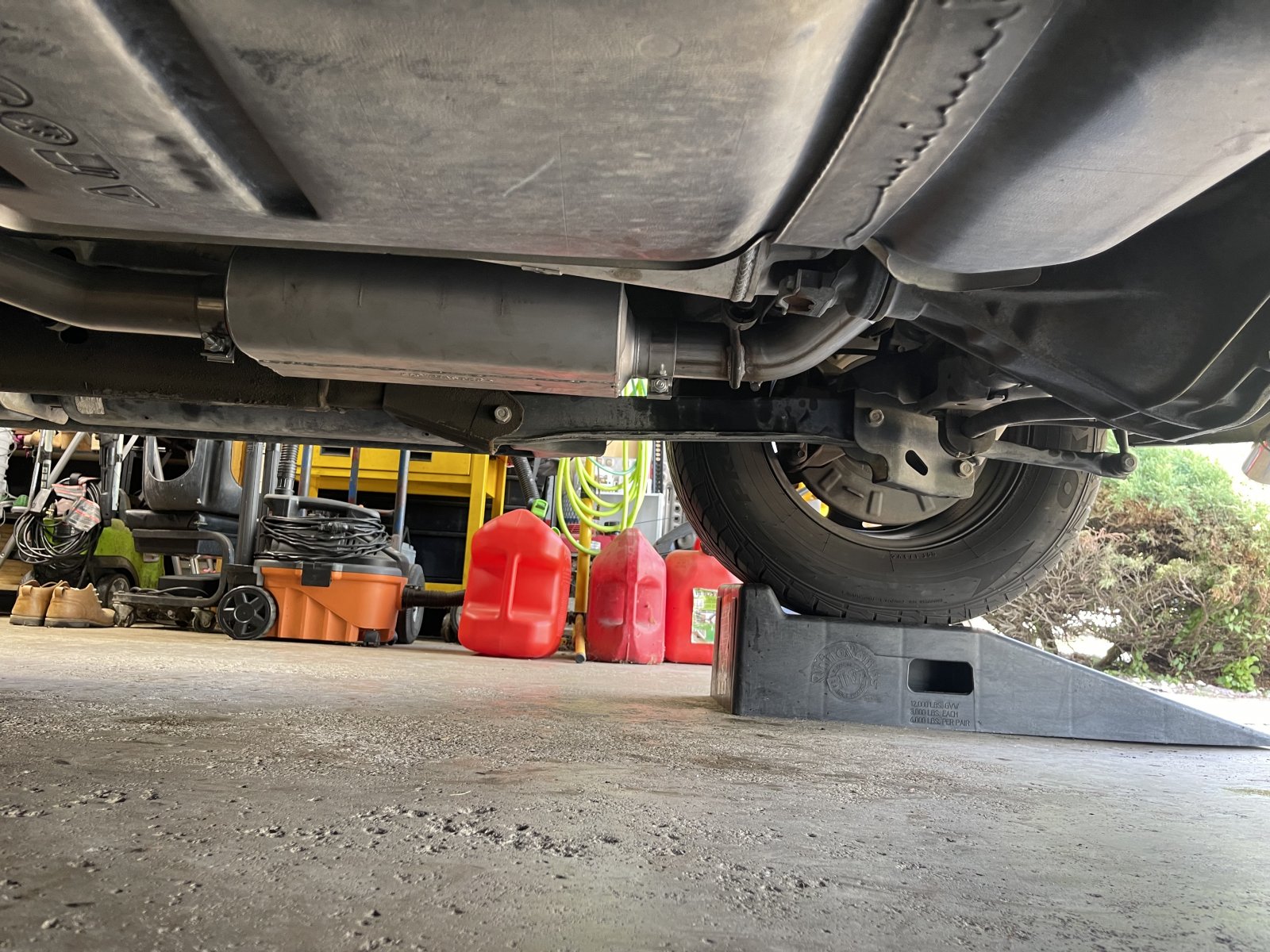

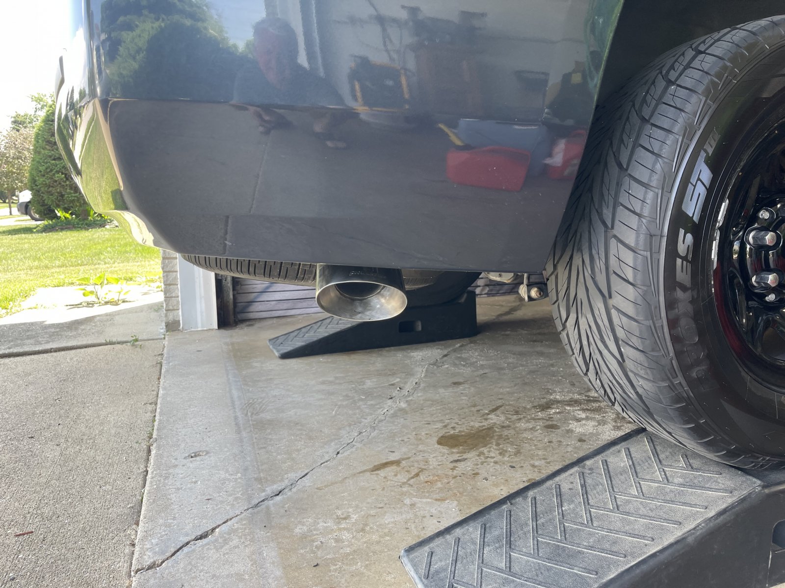

I found brand new Force II made in 2016 , waaay before Covid 19 ,
In PPV ramps are needed , for sure .
One cut after factory muffler , and spare tire heat shield need be removed temporary.
Assembly went smooth. Time need be taken to move everything around and make sure nothings runs anywhere,
This is Force II with series 50 muffler

I actually like the sound of,no drone , nice idle sound , quiet when cruising on the highway.
Took me 2 months to search , and this pops out on marketplace.
1/2 price , can not complain,
Flowmaster is still the best ‼️
