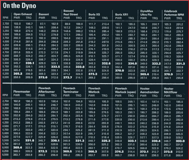

Please ignore the "experts" That claim flowmasters are restrictive. Do they make as much horsepower as a flow through design like magnaflow? They don`t but in this dyno muffler comparison test the numbers are very close between all of them and the flowmaster they tested was a 50 series suv muffler. If they tested a 40 series the numbers would have been closer.
The four horsepower difference in the test is on a mildly built engine and on a low performance truck like ours it may be less and you would never feel any difference, Just go with what sound you like. And like mizzouguy said go with stainless.
I wish people would educate themselves before spewing ********.
http://www.mustangandfords.com/parts/m5lp-0212-ford-mustang-muffler-comparison-test/

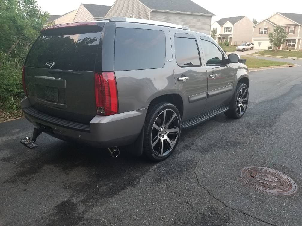

Here's my mbrp. I don't have one on the highway tho.
I think it sounds pretty good.
