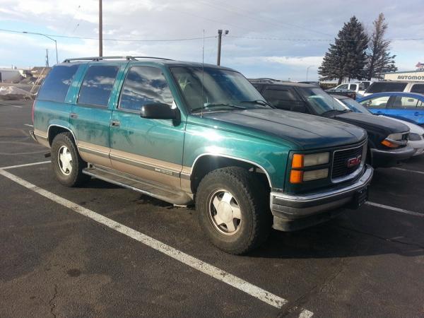

thanks all, picked it up for a steal. not bad for 2k
163k miles. the master cylinder has bean upgraded
