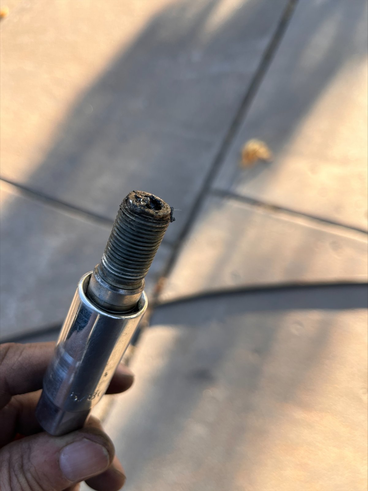

This past Tuesday the engine in my Yukon blew up, literally. I pulled the spark plug on #2 and it was flattened and difficult to get out. Upon further inspection with a bore scope..... Total carnage... The cyl is destroyed, it's been smashed to bits by the connecting rod, bits are caught in the crank and the block is damaged. I can't even turn the engine over to get it out. haha.. holy cow! This is going to get expensive.

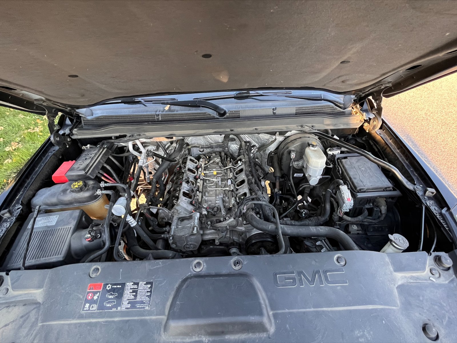

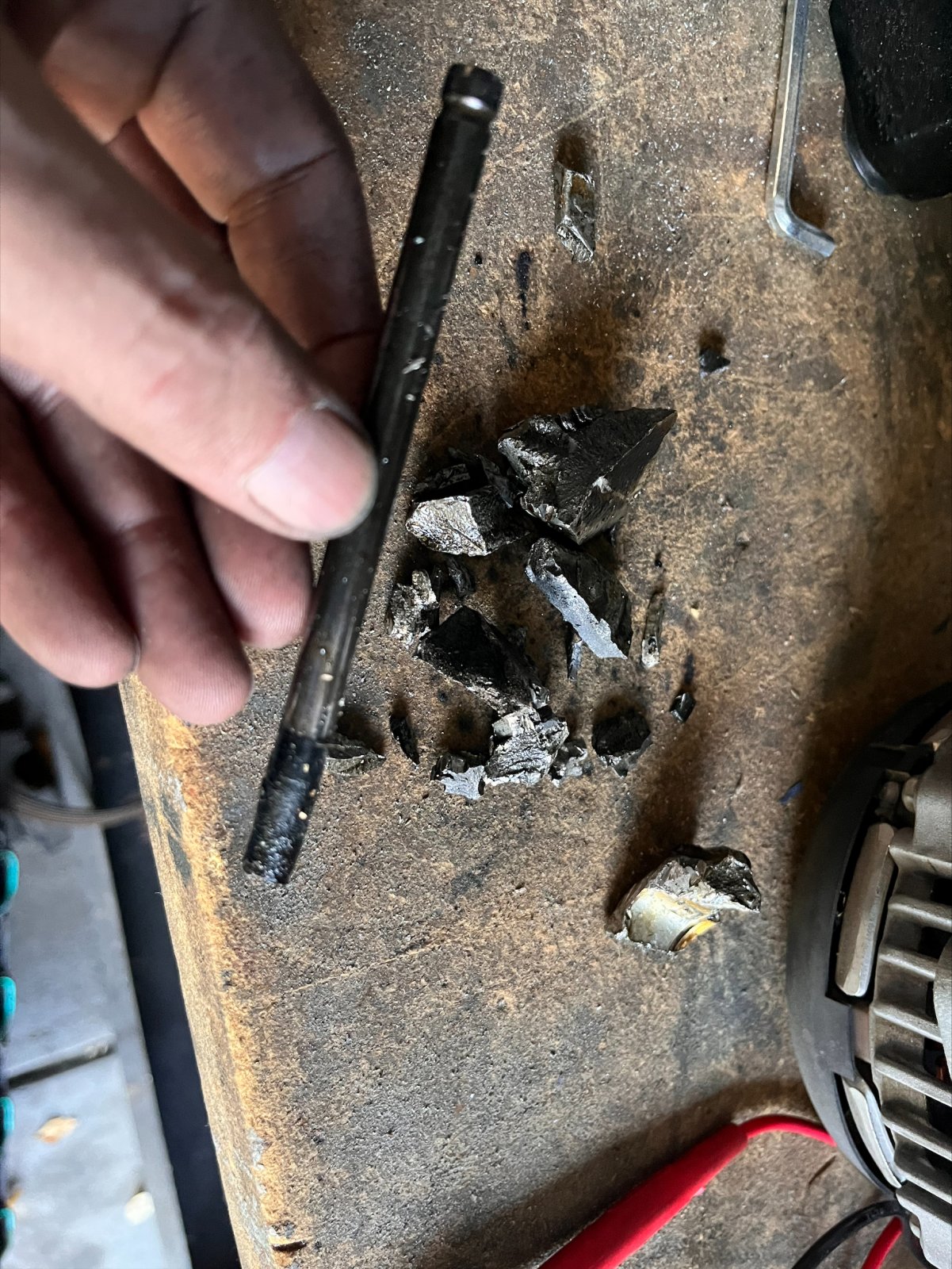

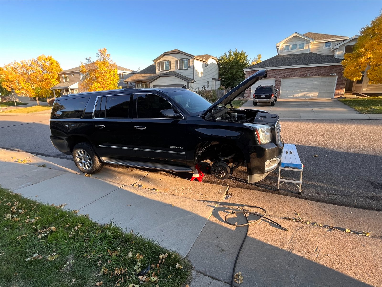

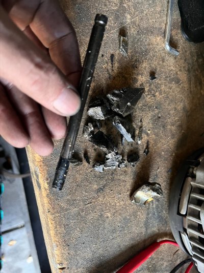

Thanks for the warm welcome guys. I appreciate the back and forth. Here's some pics of the truck. This will be back to back engines. I finished up my F350's 6.0 this past spring. That was a big job. This doesn't seem to be as much work but we'll see.
This engine is mechanically locked up so I'm pretty sure I'll have to pull the passenger side head to fish out parts and rotate the engine. Below is what came out of the intake plenum, that's not even all of it.
Anyways, to answer some of your questions, yes I plan on keeping the Yukon. I'm kinda married to it now. I'm not going to do the 5.3.. I wouldn't be able to look at myself in the mirror. I like the power and I bought this truck for the 6.2 engine.. I have not been disappointed.
My wife was driving and says she didn't hear a thing.

Good call on going back in with a 6.2. Bummer that that happened.
Were you by chance running 87 octane most of the time in that thing? That’s a fairly common failure for people running 87 in their 6.2’s. I’ve never heard of it happening to one running premium, but there’s a first time for everything.

I like the wife quip as well......heard similar over the years. But, with patience and practice you can get them to come around. LOL
Also, I love that you are doing it in the street of your nice neighborhood. Feels like something I would've done......then get looked at weird for being blue collar. Good stuff
