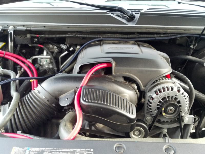

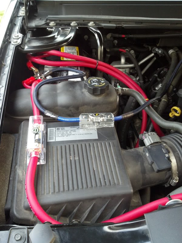

Big 3, All wires are KnuKonceptz 0 Gauge with soldered ring terminals. Have an inline 200amp ANL Fuse. Amp wiring is a Stinger HPL 4 Gauge kit. Inline 150amp MIDI fuse
Big 3 going across to Alt +

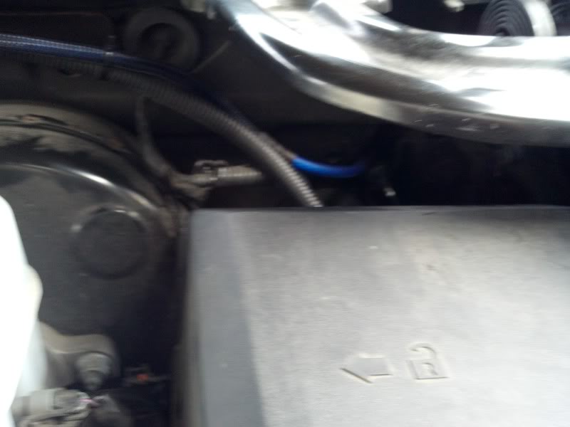

Dark picture of where I went through the firewall for my 4 gauge to the amp. THere's a rubber grommet where the trunk release wire runs from the cab to the latch. Just followed that through.

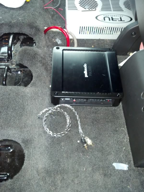

2 amps. One 2 channel Polk audio for the front compenents, 6.5" Massive Audio RK6. And the Tru Tech S500 for the 12" FI Audio Q12 at 2ohms. I found wiring the amps was pretty easy, I ran all the power lines through the drivers side and the RCA's on the passenger side, there was a channel on each side any the wires fit great. I am wiring all amps under the 2nd row seats since there is clearance for the amps there.

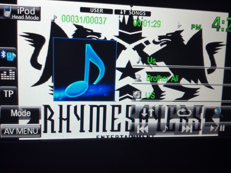

JVC Pic

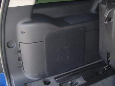

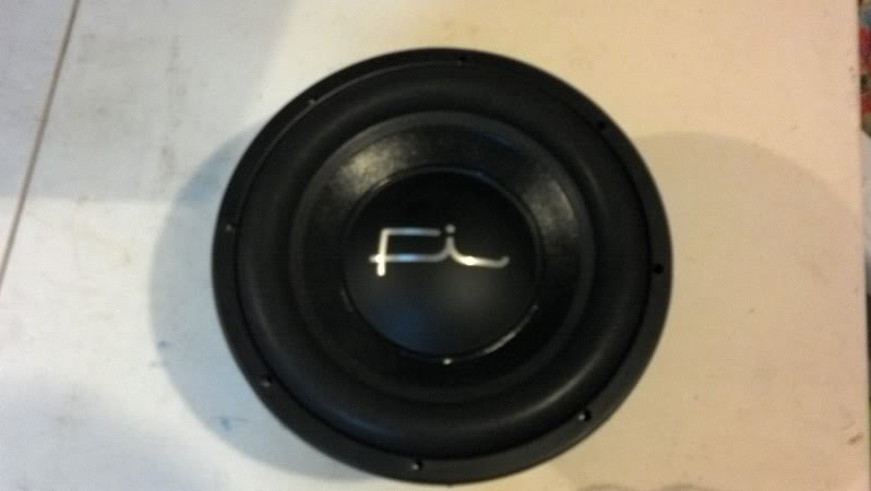

My Sub FIQ12. I'm looking for opinions on mounting this sub, kind of stealth in the cargo area. I've never fiberglassed but I've seen a lot on doing that where the spare tire tools are kept, I'm not sure, if there are any pics of single 12" subs, mounted stealth in the cargo area I'd appreciate it.

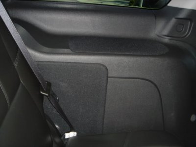

Not mine...not sure of sub size...might have gotten these pics off of this site...

Looks like he cut out that part of the cargo area? I wonder how he got the box to work? Maybe a wood insert?

I read through that forum, I need to figure out how to get my sub back there as it's pretty deep and has a large magnet. May end up going a whole different direction. But thanks for the link.
