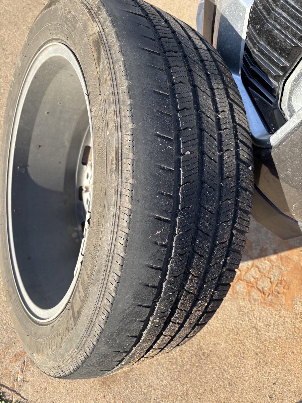

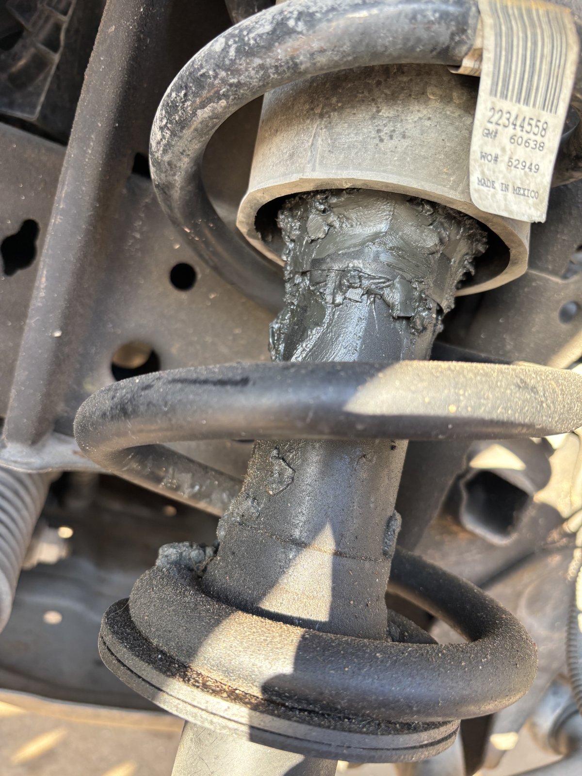

2021 Yukon XL Denali 2wd. Started getting the bounce over bumps at highway speed. It ate the inside shoulder of the tire pretty bad and the driver side shock/strut assy is covered in what looks like bearing grease. Passenger side is clean. Replace suspension parts/tire, get an alignment and send it? This is my wife’s vehicle. Many thanks.

That grease-looking stuff on the strut body seems too thick for strut fluid, and it seems too much in quantity for the bearing assembly failure in the top strut housing.
Further, the tire wear is not likely related to the strut itself, unless the strut itself disintegrated, which you would have noticed much earlier.
The strut has to come out and get inspected and most likely be replaced. I would start there, and if it turns out that the strut itself needs replacement, do that. Thoroughly check out the entire suspension on that side to see if anything else is loose and/or worn, and potentially causing that tire wear. If you find anything that needs replacement, do it. Then after all of the work is done, get an alignment.

that strut is toast I have seen them like that before the grease just turns to goo
It "may" have contributed to the wear but I bet there is more suspension parts needing replacement+alignment

I take the blame on this. I knew it had been doing the highway "floating" over bumps but had not gotten in there to inspect. I will get an alignment first and foremost and hopefully they will be able to identify any loose/worn parts. For now I have rotated that tire to the rear and need to identify something that is cost effective to replace both front shocks/struts. They are the electronic version and I'd be happy to replace with anything that will keep the tires planted and wearing properly. The current units are BWI, but no idea how long they have been on there.

Just replace the OEM Magneride strut from r/a, it’s not necessary to replace the spring. The sleeve cover looks ok.
Always replace suspension parts in pairs. Alignment issues can be worn upper, lower or strut top bushings. Check them all when apart.
