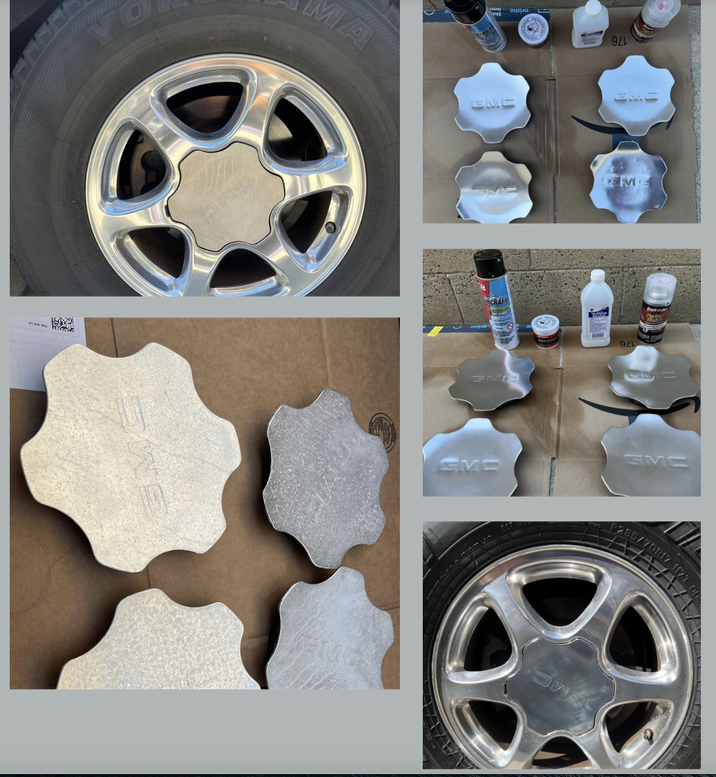

It's the clearcoat that looks bad. Pick up some Aircraft Paint Remover from the auto parts store and use it to strip the clear coat off. Not sure what's different about that paint remover...it's what was recommended to me. Afterwards just polish them up with some good aluminum polish. I did this on my 04 Denali and the center caps turned out great!
I did this and worked well! Thank you for the info, here are some pix for anyone interested.
