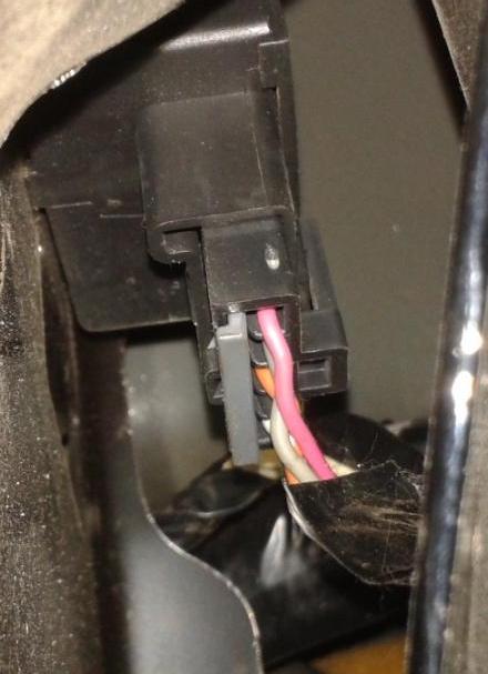

Here is the connector

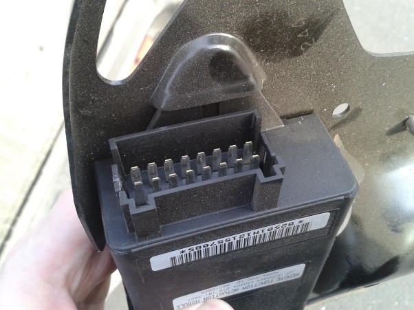

And reciever

Uh those don't match at all. Unplug it before damage is done. That connector looks strongly like the interior light module connector. All the wires match that device diagram.
