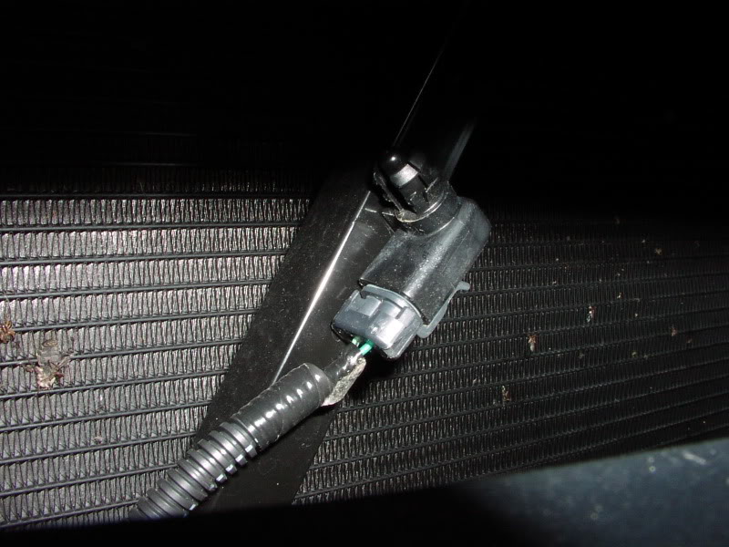

2005 Yukon Denali, 160,000 miles. My exterior temperature gauge in the center rear view mirror is way wrong. Says it's 95, it is actually 68. Said it was 141 the other day, it was actually about 95. Anyone know where the sensor for this is?

in front of radiator.
look for something similar to this.
