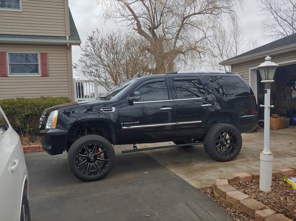

Removed the front factory struts and replaced with KYBs stock were blown out kept the auto ride in the rear extended the leveling sensors with 10-24 threaded rod running fuel mavericks 22x10 -24 on 35 12.5 22 renegade AT5s rides nice kit was straight forward and well built and didnt cost a lot of money aligned real easy took me 3 days with no lift in my garage with no hoist roughly a day for the front 1 for the rear and 1 to modify the front fenders and paint up the wheel wells and no vibration no lights

Hey, good lookin' ride! Any more pics of the rear shock setup and front fender trimming? I'm about to do something similar on mine and just trying to make sure I have everything in order. Did you do rear shock spacers?

With the AWD I haven't noticed any adverse effects yet but this is not my first lifted truck but it runs smooth 85-90 down the E way the truck has 133k on it but I've replaced all the suspension and bearings while I had it apart which probably helps a lot . Just lift it

The rear came with shock extenders and the air ride shocks bolted right up I'll try and get some picks of the trimming but I just did what everybody else did . watched a couple youtube vids on custom offsets its the same on tahoes and the trucks same wheel well dimensions . What grill you running I have the amarillo egg crate one ready to bolt on and was going to run the new style emblem as well

Nice, thanks for the info pics! I had that aftermarket grill with the new style emblem, but found an all black oem grill that I liked better and put that on. I have everything together for the lift so as soon as I get some time I'll put it all on and post pics on my build post.
