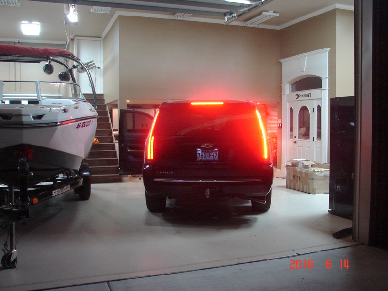

I'm going to attempt to explain this... So I decided to get a set of the OEM escalade lights and see how they fit. ... .

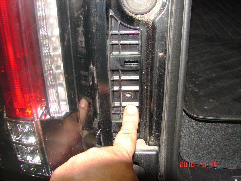

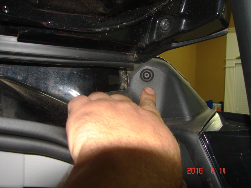

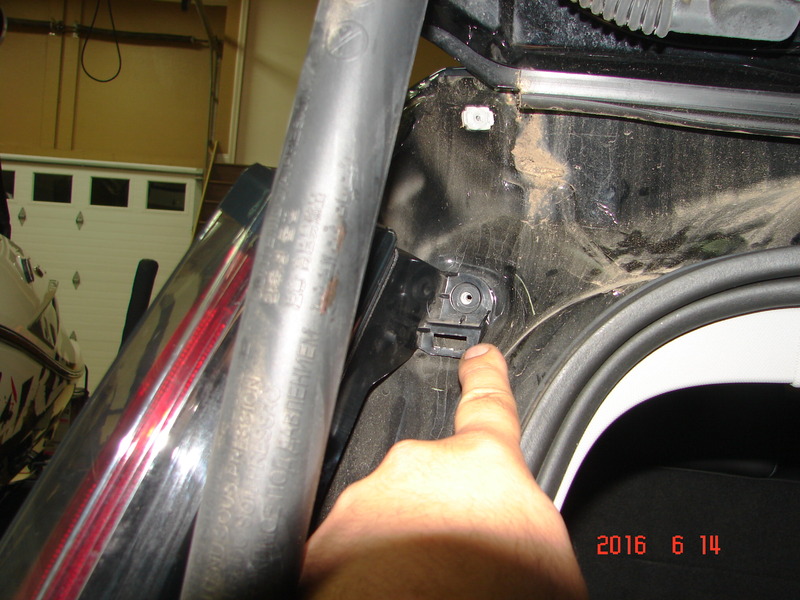

I then install all 5 of the factory t15 screws back into the light and put the two factory snap in panels back on this is the easy part. I hope this helps some of you guys out if you have any questions I'll be glad to help.

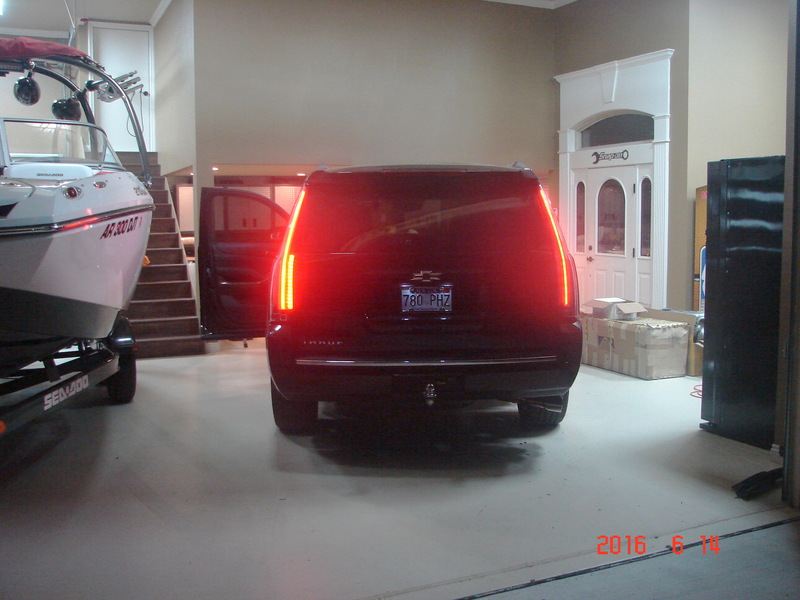

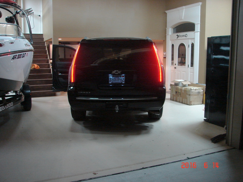

The pics below are for reference showing vlands and oem escalade lights side by side. The drivers side is a vlands light the passenger side is a oem escalade light.
This is just the parking lights these pics look crappy and don't do them justice. But in person the vland lights look better than the escalade lights far as parking lights but that's it.
Now this is a pic of the brake lights as you can see on the vland both led's long and short are on. The escalade light only the long led bar is on and there is no comparison the escalade ones are way brighter than the vlands.

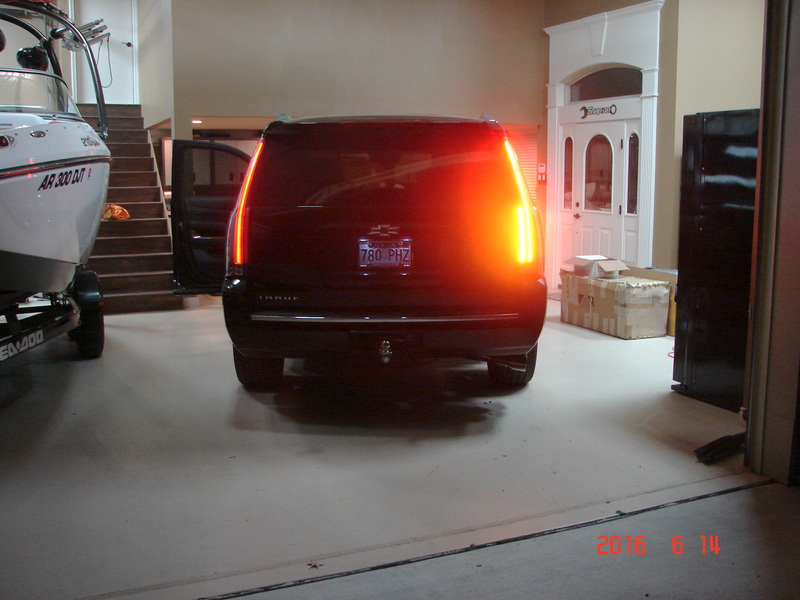

Here's a pic of the turn signal on the escalade light both the yellow short led bar and long red led bar both light up these are very bright.
Now this pic is the drivers side vland's turn signal both the short and long red led bars light up but are very dim compared to the escalade.[/QUOTE]
