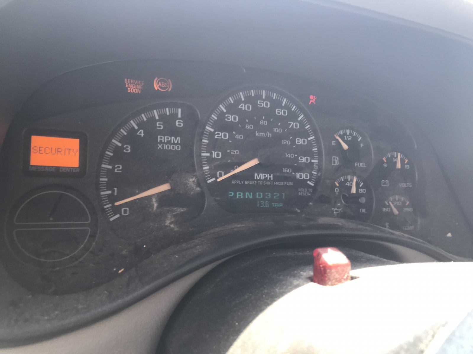

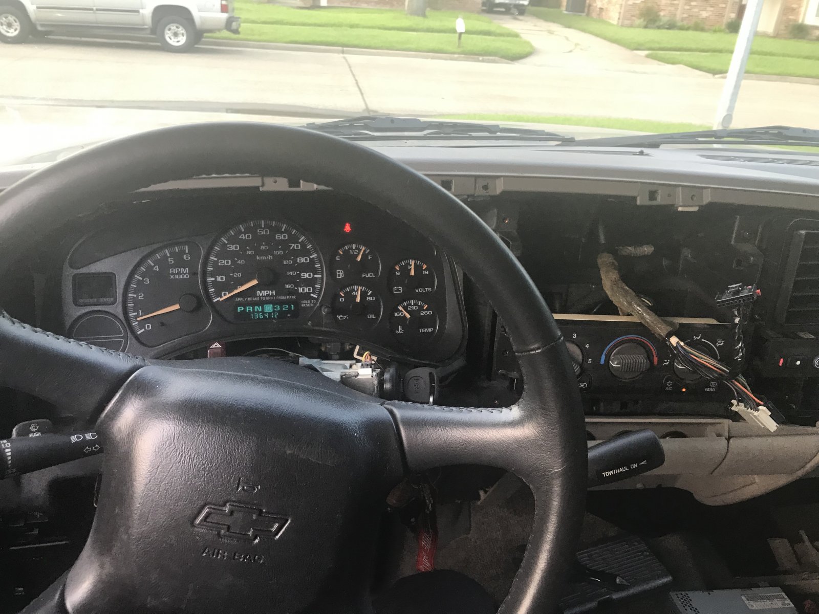

I’m having trouble with my cluster too, did you fix yours?
