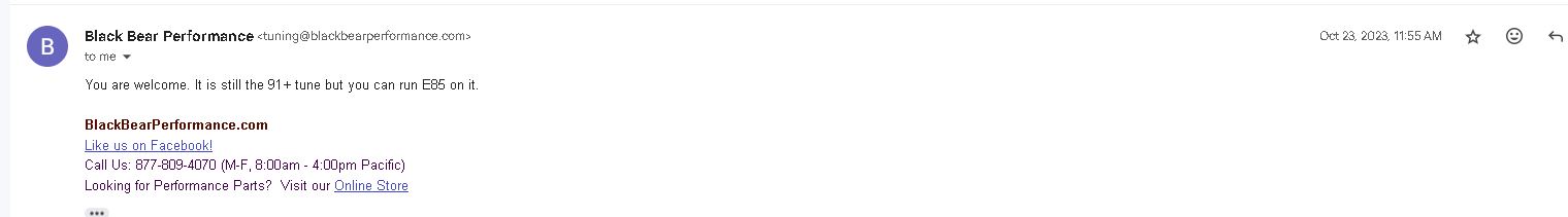

I believe I asked them as well and I believe the short answer was that that 92 tune works just fine with e85 in other words no additional beni's
I could be wrong though, dug in my emails and this is what he said

That is correct. We do not have a tune that is specific for E85, but if the vehicle is a Flex Fuel, E85 can be run on our 91+ or 89-87 octane tunes.
