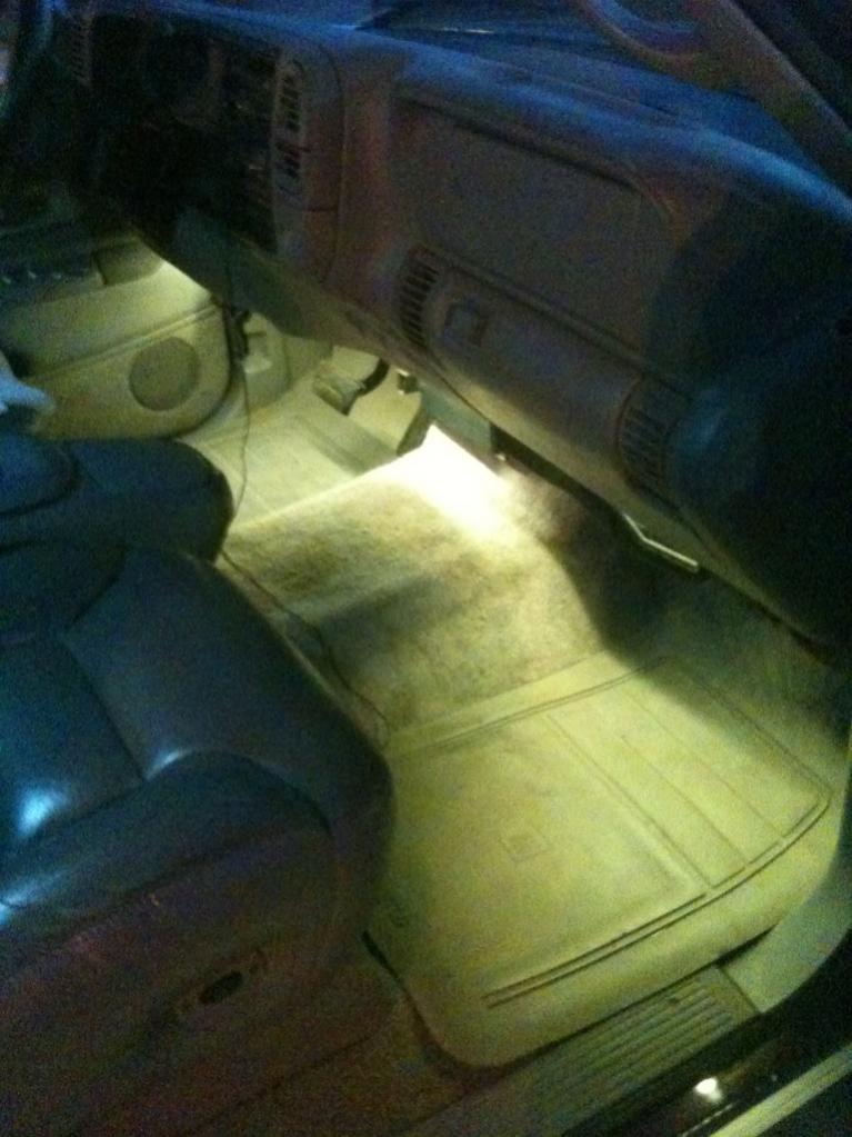

Here is a comparision of one 8" strip.

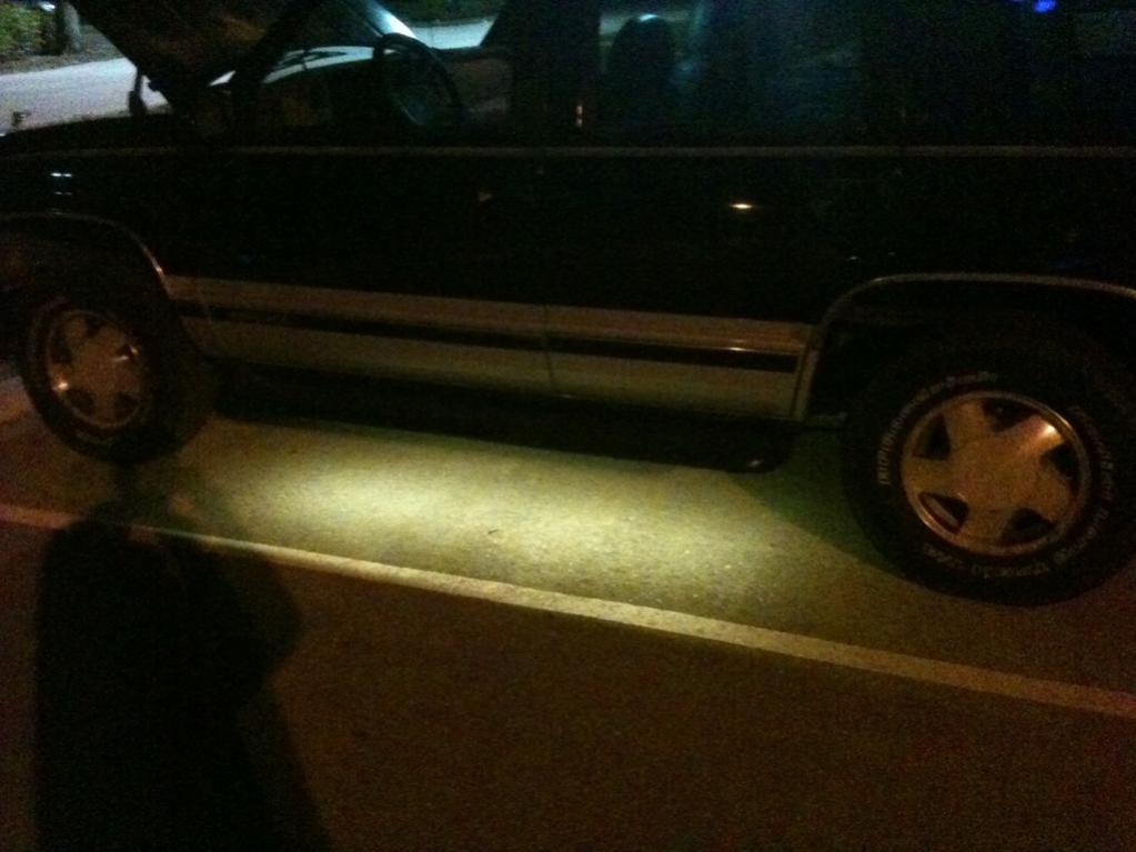

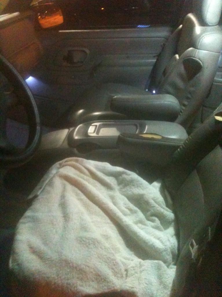

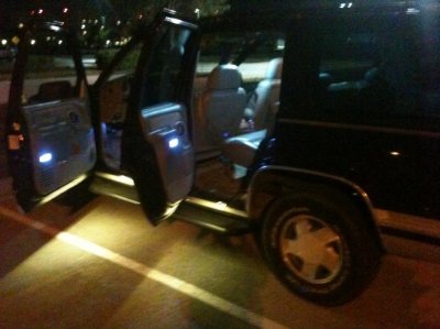

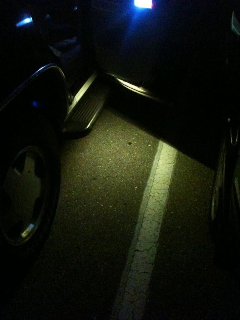

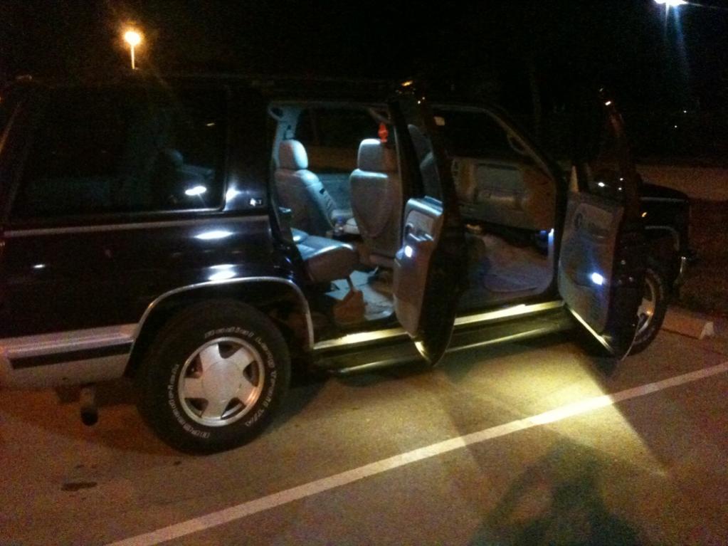

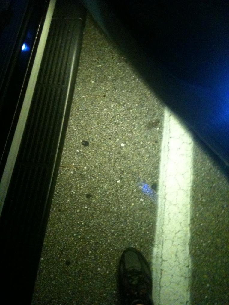

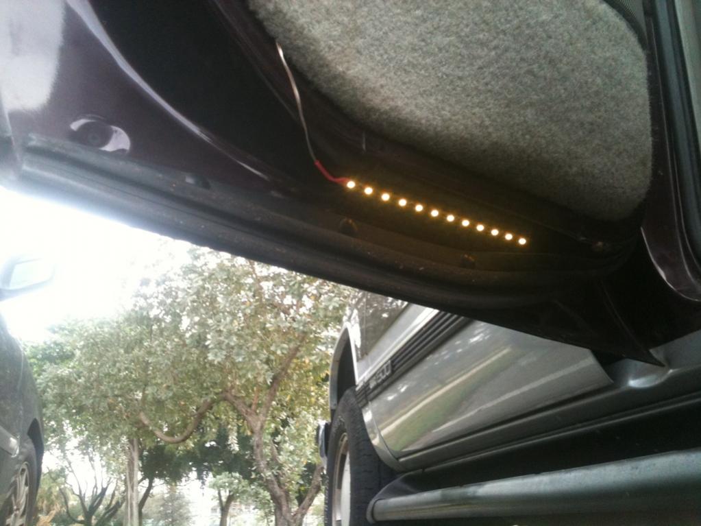

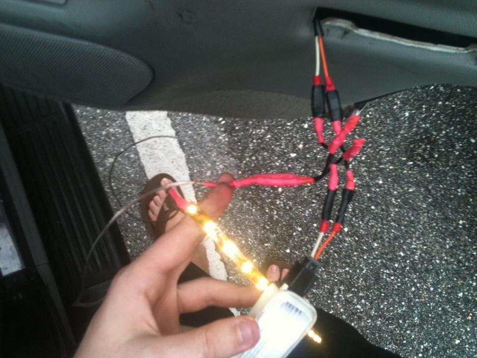

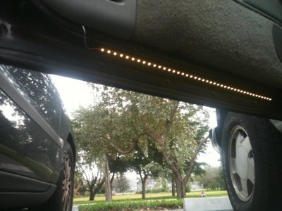

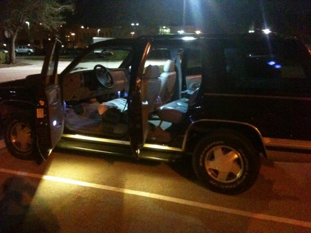

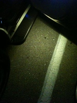

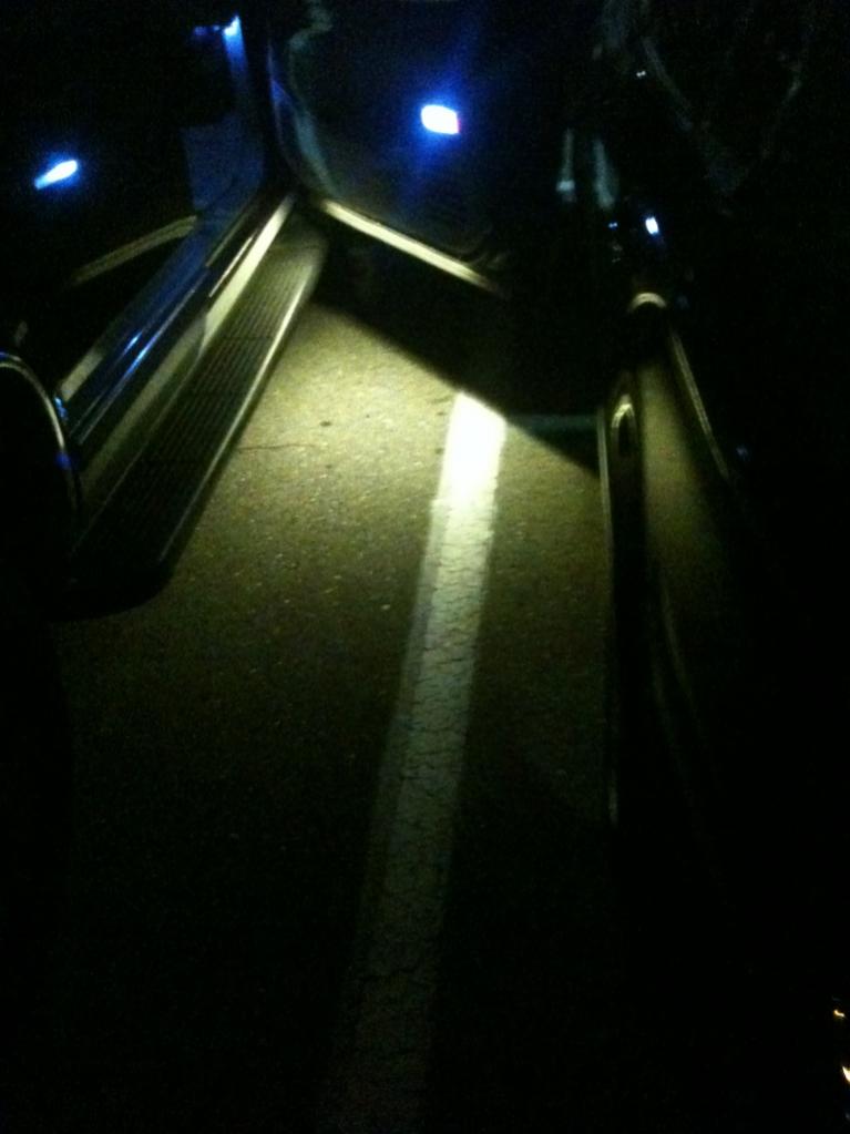

Just waiting for it to get dark so I can see how bright they are. :D
I spliced into the power from the courtesy lights on the door. Normally I would have used a relay, but I swapped the door lights to LEDs so they use less power and can handle the extra load of the LED strips.

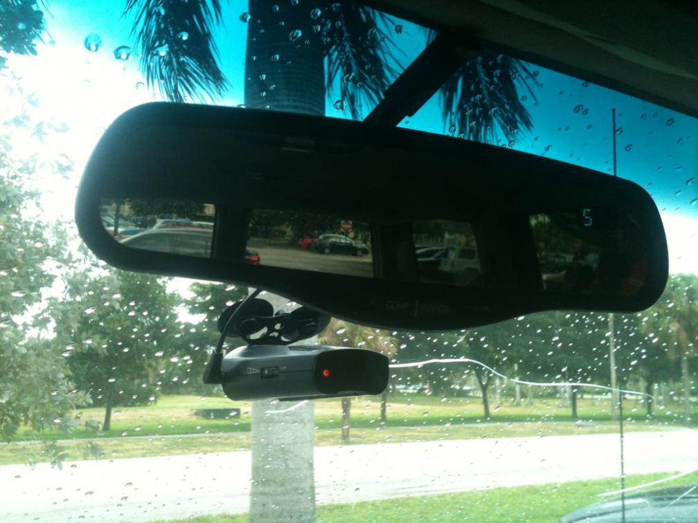

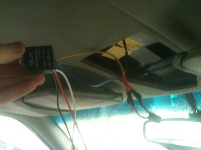

Hard wired the radar detector. I spliced power from the map lights and used the on/off from the power mirror.
Now it comes on and off automatically when I run the truck.

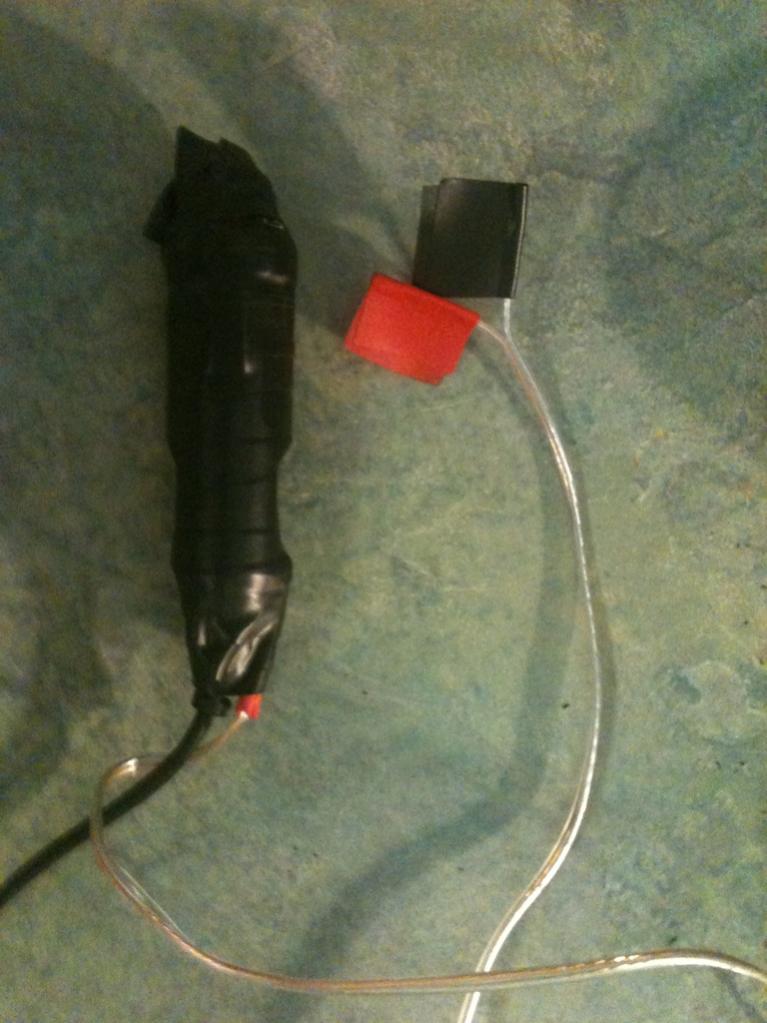

The first picture is the cigarette plug. I opened it up and soldered an extra set of wires for power. That way if I ever need to the cigarette plug still works.
The third picture is the spliced in power for the relay. After this picture was taken I cut the blue wire and ran the red/black from the first picture to this blue wire. I ran a signal wire from the power mirror to the relay. Works great.

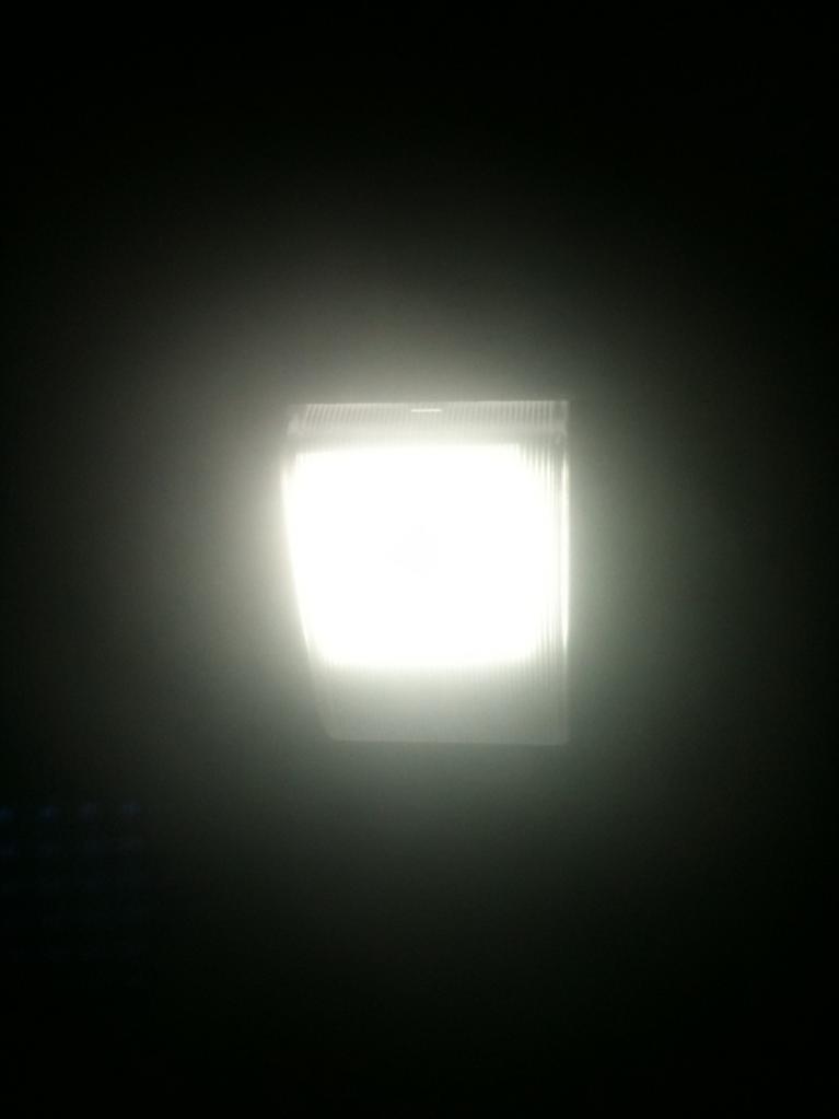

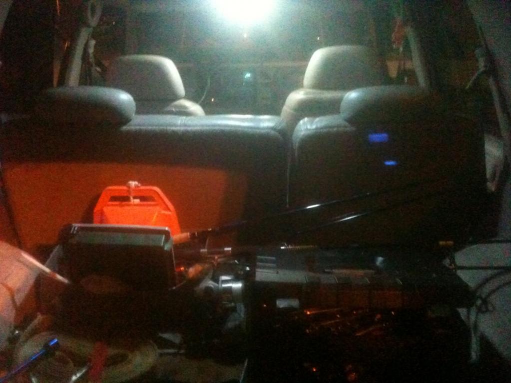

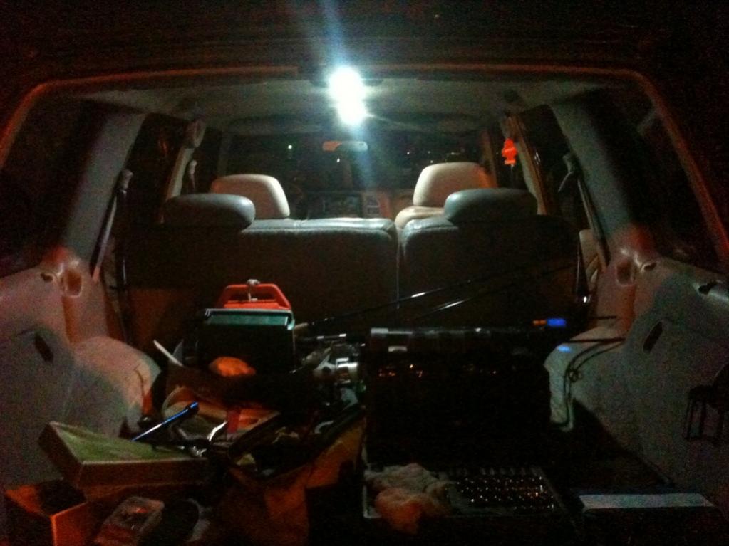

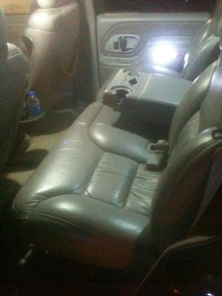

New dome lights. 36 smd led panels

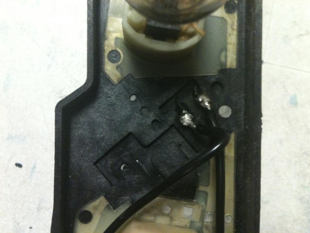

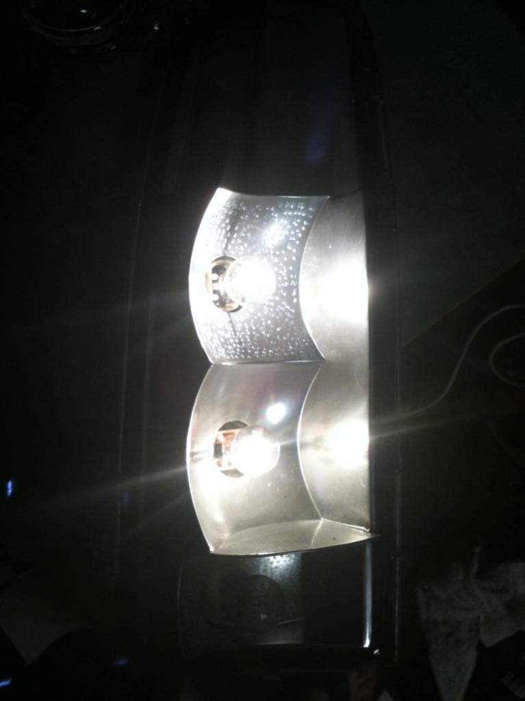

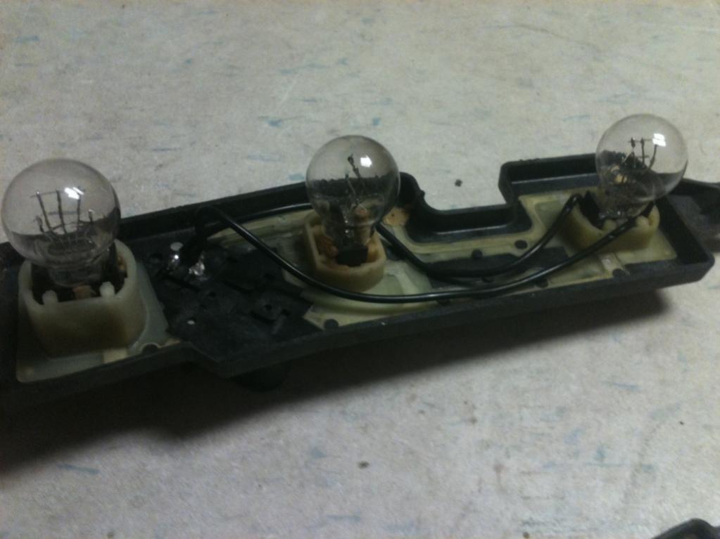

Please go into greater detail on this
What exactly did you want to know?
The link I posted has all the info.
Its kinda ghetto! Both bulbs are dual filament, but only the bottom bulb uses both filaments. This mod allows you to use the use the second filament on the top bulb. You solder one end to the board and jam the other ends in the socket.

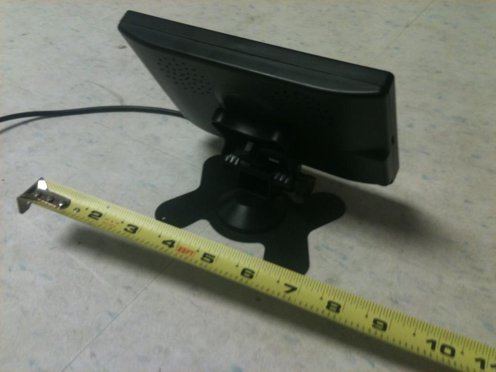

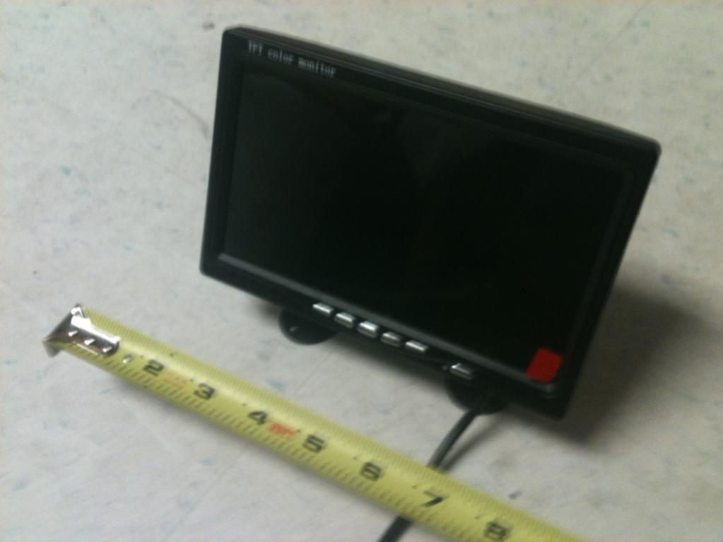

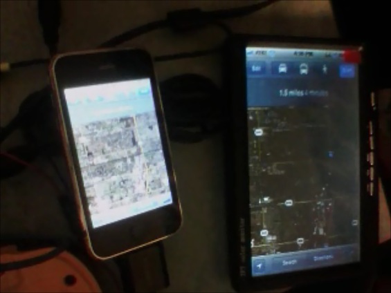

I got some goodies in the mail today:rocking:
7" TFT LCD monitor: 12v, 2 video inputs, ...$36
Sorry about the crappy first picture...I had to use my webcam.
I thought is was broken at first because it had a white screen...it was just low voltage in the 9.6v drill battery I had it hooked up to. D'oh! :emotions122:
