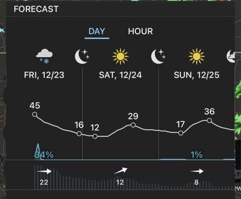

Temperatures are dropping below zero this weekend - are most 3.0 owners using additives?

I'd definitely put in some Power Service this weekend. Can't hurt anything. Also plug it in if it sits outside and you plan on using it. If you aren't, then plug it in about 6 hrs before you go somewhere. In all reality this cold will probably hardly faze it, really....These vehicles are more robust than you think...

Thanks all, I picked up some “hotshot diesel winter anti gel” for todays fill up to be safe.

Good info here. We are going to get close to 10°F. Do I need anti-gel? It more than likely will be parked outside.
