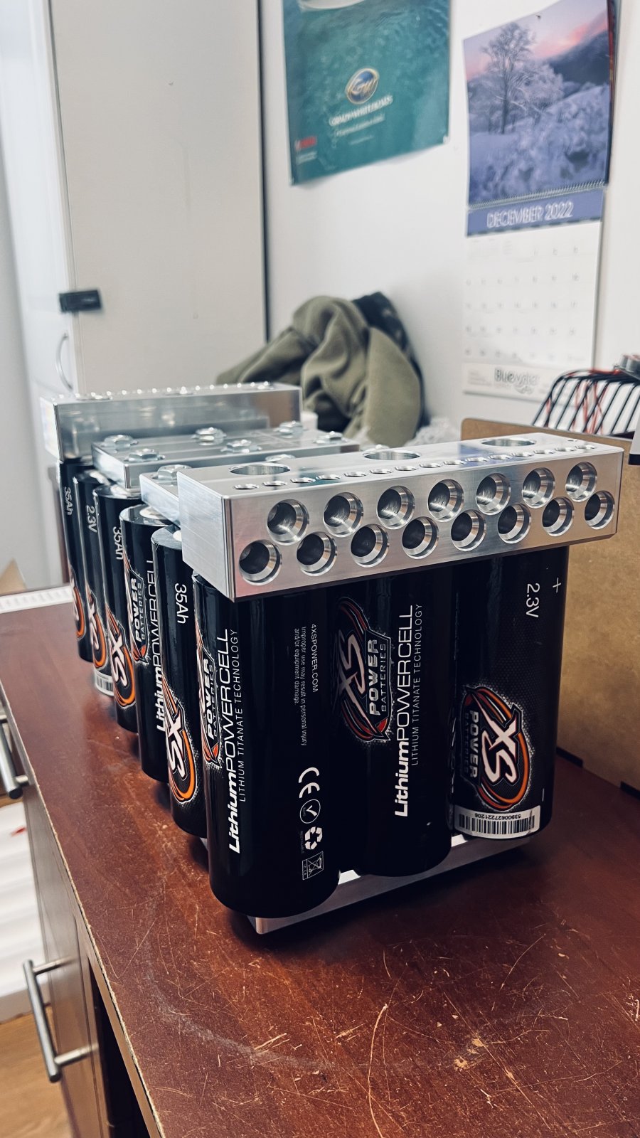

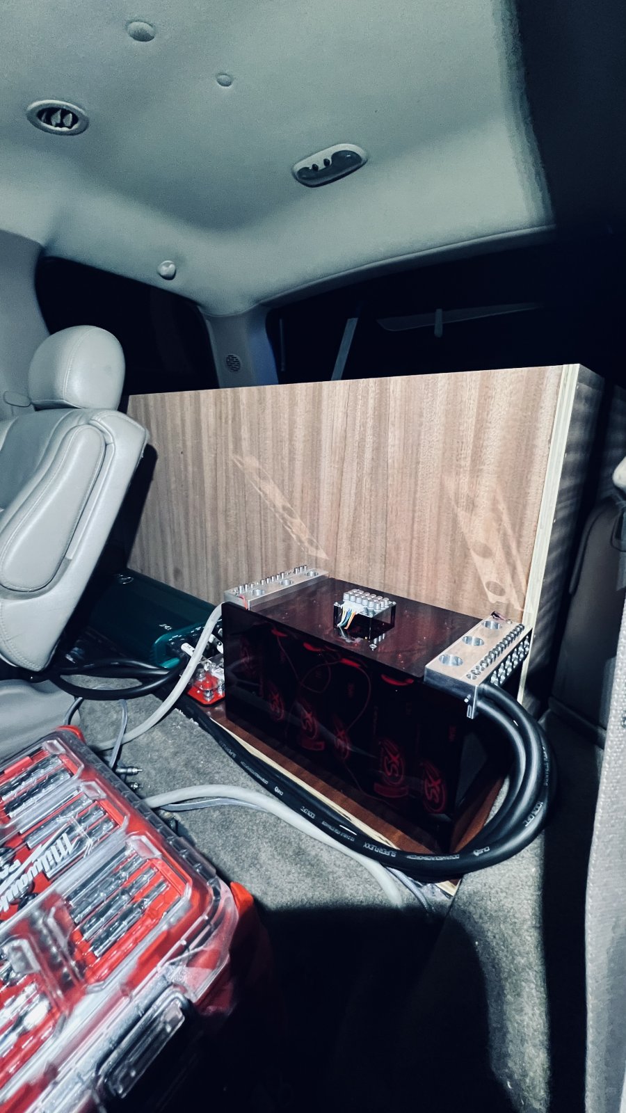

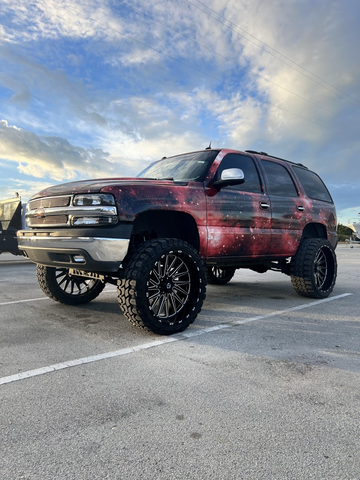

I will say my buddy done a lithium swap in his Tahoe I don’t know what your trying to run but he did 12 cells I believe and he was pushing over 20,000 watts in it
Trey Hardy
Jun 12, 2020
3,552
9,637
I want to say he never put any under the hood he built a dummy battery which wired up to the yinlong cells in the trunk for starting
