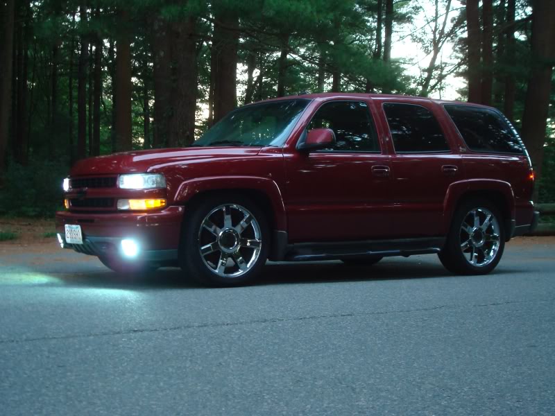

currently its at about 3-3.5" upfront and the rear is about 4.5" or so from stock, although i only bought the 2/3 kit then eventually the torsion keys since the back got dropped too much and almost looked like it had reverse rake and the front looked higher than the rear, but it was basically dead even.
how it sits currently
lost my signature trying to update it, now i can only get little tiny pictures to be the sig

Mass-hoeZ71 that's the look, I am going to take the rack off. How hard is it?
Are those 22's I have 20's so it should look higher.

Takin the roof racks off is easy, just need a #25 torx bit ( i think i only used a #25 for allof the screws but it was awhile ago)i believe and a ratcheting driver if you want to make life easier for yourself. The covers take a bit of convincing and wiggling to take off. Then i just used some set screws and rtv silicone to fill in the threaded holes and i havent had any trouble with it.
Yup, 22" esky rims, 285/45/22 tires

Mass-Hoez71- looks good bro. One thing I like about those fender flares, makes the whole truck look lower. I have the McGaughy coils, and love my ride quality, even tho I'll probably end up bagging or get those tb springs. Did you do free travel mod? Have lowered shocks? Those two things, drastically help the ride quality!! I had a 2-3/4 McGaughy drop with out bump stops removed, and the rear was super rough!!
MASS-HOE'Z71
Jul 6, 2009
455
Mass
thanks broski, i appreciate it, your trucks lookin pretty sick too. alot of people hate on the fender flares but for me it gives me that "husky and low" look im going for.
did the free travel mod and remounted the half end of the bumpstop to the frame so i have about 4.5" of travel from the axel to the bumpstop. im running the belltech street performance shocks all around and some shorter sway bar end links that were originally on a denali but were shorter than my stock ones. the rides isnt horrible by any means but its definately not where i would like it to be, and any pot holes in the street i better swerve around or im bouncing all over the place.
