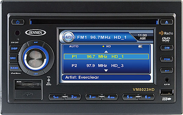

This is what I'm looking at getting:+
http://www.crutchfield.com/p_110V8023HD/Jensen-VM8023HD.html Because it has HD radio, Ipod support included which are usually like 75 in extras.
and
http://www.crutchfield.com/p_120GMOS04/GM-Factory-Integration-Adapter.html which I get for $49.99 with purchase of that deck. and the Antenna adapter and Mounting bracket is free
Also, Do I just ground the "brake to watch video" cable so it's enabled all the time?
Whats your opinion JK on this set-up or anyone else :)

Install time will depend on your experience. 15 mins for me. If this is your first time, you should be able to get it in within an hour.
Jensen has come up the past couple years. Their products are much better than they were a few years ago. I haven't played with that particular model yet, so I'm not familiar with the features and the particular sequence for the parking brake lead for the video. Some units need to see ground on the parking brake input lead to show video. Some need to see gnd, off, then gnd again before the video will show. This will make a difference on how you hook it up if you want to show video while not parked.
sdgd711
May 15, 2009
58
Atlanta, Georgia
If I remember correctly Jensen needed a switch to bypass the parking brake. I think the sequence was start in off postion, on, off, on. They may have changed that, it has been a few years since I put one in. You may also be able to use a PAC TR7 and it will do it automatically.
weezel66613
Jul 8, 2009
The adapter crutchfied will give you for free will not be the onstar/ bose adapter. They just give you the standard chevy adapter. Also if you plan on retaining steering wheel controls make sure you can get an adapter to work with that radio. They do make universal steering control adapters that have an IR emitter that has to stick out in front of the radio(in corner) and can be programmed with the radio remote.
