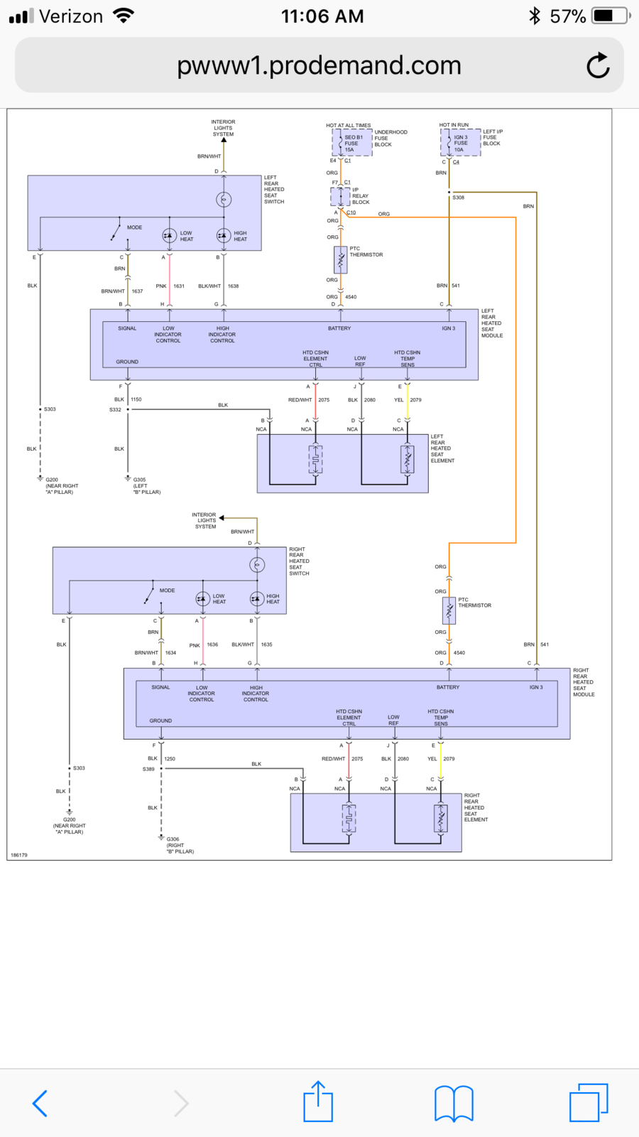

I need some help from someone who has access to wiring diagrams or schematics. Or even if you can guide me to the right website where I can find this info on my own, without having to buy a subscription. I am looking for the heated seat wiring and center console wiring for a 03-06 Escalade. I am specifically looking for the wiring for the rear heated seats, which have the heated seat buttons on the back of the center console that sits between the two front seats. Any help you can give is greatly appreciated.

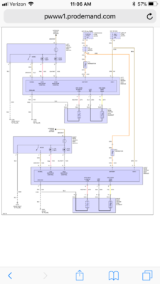

Here ya go Scotty
