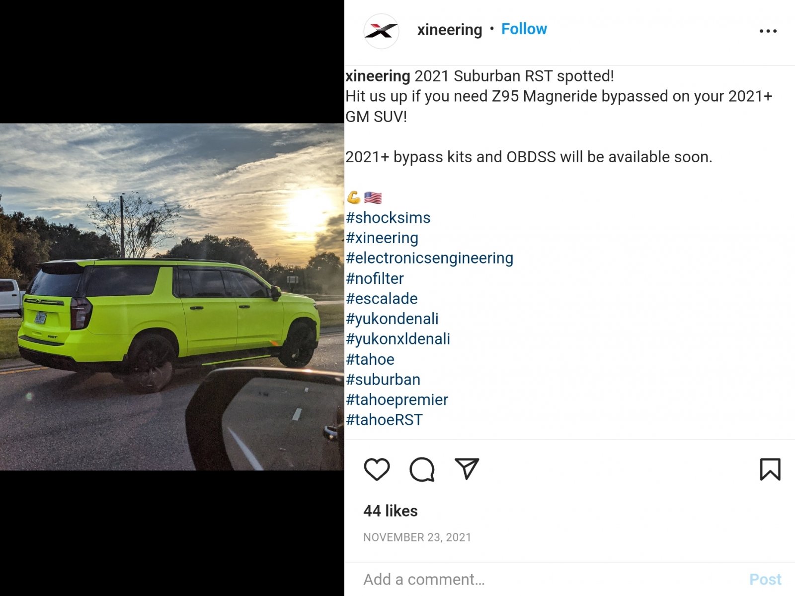

EXACTLY. COIL OVERS all the way around. I have looked into belltech lift, and been rolling it around in my head taking the RC3.5 off. Fabtech has lift as well with coil overs As you mentioned.
This company says they have the kit to override the magnetic ride control system. They posted a fluorescent green suburban on IG page and said ask us about our Mag Ride delete.
I haven't reached out to them. Went the RC3.5 route at the time, cause it was what was available. Now options are starting to appear. I think net direct had a tahoe listed with a 7" full throttle lift. I am gonna have to contact full throttle as well... almost to the 8" I want....lol.
https://www.xineering.com
