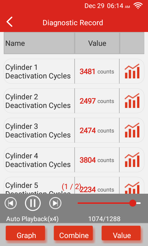

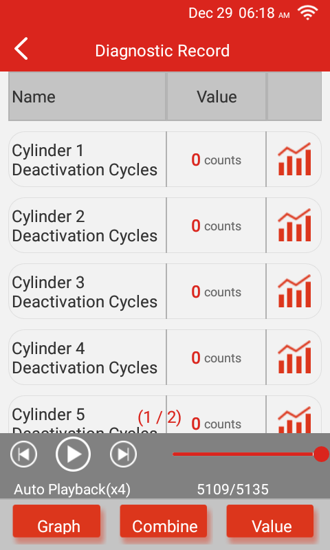

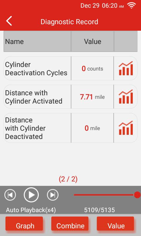

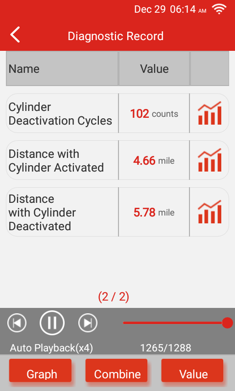

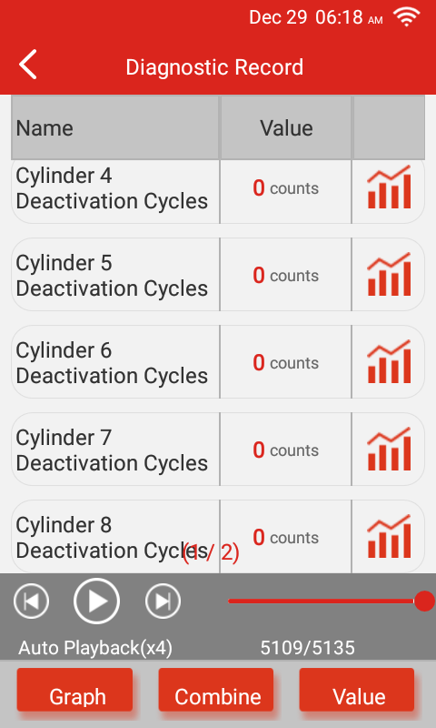

I promised a long time ago in this thread that I would log some ECM data with my scan tool with and without the Range DFM module installed. Well I finally had a reason to remove the Range module this weekend (truck went to dealer for the FPCM replacement recall) and I took that opportunity to log some data with the Range module off the vehicle. There was so many data points I could have logged using my scan tool, I settled on a very simple metric that really shows when DFM is active vs. when DFM is deactivated. See screen shots below.
These first two screenshots are logged on a short trip with the Range Module removed. This is driving normally around town where I live. As you can see there are thousands of counts of DFM turning on per cylinder. I like seeing the last two data points, Distance with Cylinder Activated and Distance with Cylinder Deactivated. I guess I forgot to screenshot the data for cylinders 6,7,8, but they showed the same data, with a few thousand counts per cylinder like you see on cylinders, 1 thru 5.

These next few screenshots are with the Range Module Installed. I did a similar route, just around town where I live. You can see there are zero counts of cylinder deactivation on all cylinders. Meaning the Range Module is doing what it says.
DFM Disabled Range Installed 1.png DFM Disabled Range Installed 2.png DFM Disabled Range Installed 3.png
