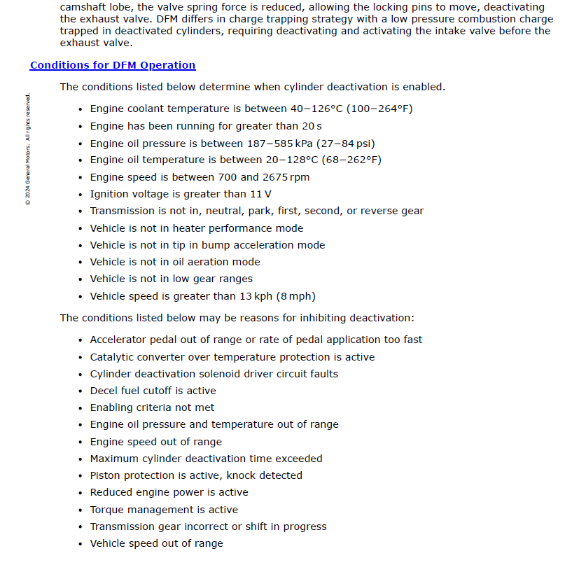

How did this ridiculous rumor get started? Read GMs own service description of DFM operation that was posted earlier in this thread. DFM is NOT active during deceleration fuel-cutoff mode aka what you experience when coasting down with quiet exhaust. The engine re-fires at 14mph slowing down if you continue to coast.
DFM IS NOT ACTIVE DURING DFCO. Not sure what else to say. The solenoids aren’t energized and the lifters aren’t being de-activated. DFCO is normal operation whether the engine has DFM or not. My company 2500 with the L8T does the exact same thing. If you want to remove this behavior you need a full tune.

NO! Stop with the misinformation. Some of you are wittingly or unwittingly getting caught up in marketing between two competing business. See below directly from GM. DFM is NOT active during deceleration fuel cutoff. Deceleration fuel cutoff is on any time you are coasting outside of some vehicle warmup logic in the ECM. NO LIFTERS ARE DEACTIVATED DURING THIS MODE. NONE.

L9 activates engine braking logic in the ECM/TCM and also inhibits DFM. DFM does not activate during DFCO in ANY ECU MODE. There are logic changes between coast/engine braking modes and that is what you are experiencing. I'm going to post this until y'all get it.

There is no answer to "find." GM clearly spells out the logic and operating modes of DFM. You're more than happy to see for yourself by using a scan tool and waiting for the DFM flag to light up during coast down. You'll burn every drop of oil in Saudi Arabia before that happens because the logic isn't in the ECU.
You are WRONG.
Again, you're arguing semantics, the lifters collapse on deceleration because DFCO orders the DFM lifters to do so. If you want to say that's not part of DFM fine, but the lifters are 100% collapsing during the deceleration portion, even Range Tech has admitted this and said they left it on intentionally because when they tuned it out, it made the driving experience different.
You are the one spreading the misinformation here.

'The conditions below MAY be reasons for inhibiting deactivation'
'Decel Fuel Cut Off is active'
As in, MAY, or may NOT.
Any English teacher or proofreader will understand that DFCO might allow cylinder deactivation,
or that some DFCO events might also coincide with some cylinder deactivations.
DFCO and cylinder deactivation are two separate different UNRELATED things.
However, they are NOT mutually exclusive.
(I.E.: I MAY achieve turgidity even when NOT distracted by the thought of Milana Vayntrub in a bikini.)
because
Antonm, DFCO does not cause cylinder deactivation either.
Their occurrences can overlap without one causing the other, however.
Since Antonm is not going to win any money by RG23RST being wrong,
and RG23RST is not going to win any money by Antonm being wrong,
ultimately, Range has already admitted that they did NOT deactivate 0-cylinder mode,
RANGE IS WRONG, and Milana Vayntrub is gorgeous.

If Range corrects this error (which the obviously have the ability to do) , I'll happy jump back on the Range Tech band-wagon.
