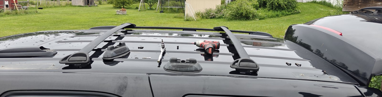

Dooood.....thanks for the reply! I have old Yakima towers and crossbars laying around from the Saabs and BMWs I used to own, and for tïts & pickles decided to see if I could get the Yukon rails off to see if the Yakima towers bolts threaded into the Yukon roof bosses.
Yes!
What spacing did you use in yours? I only have two towers available per side.

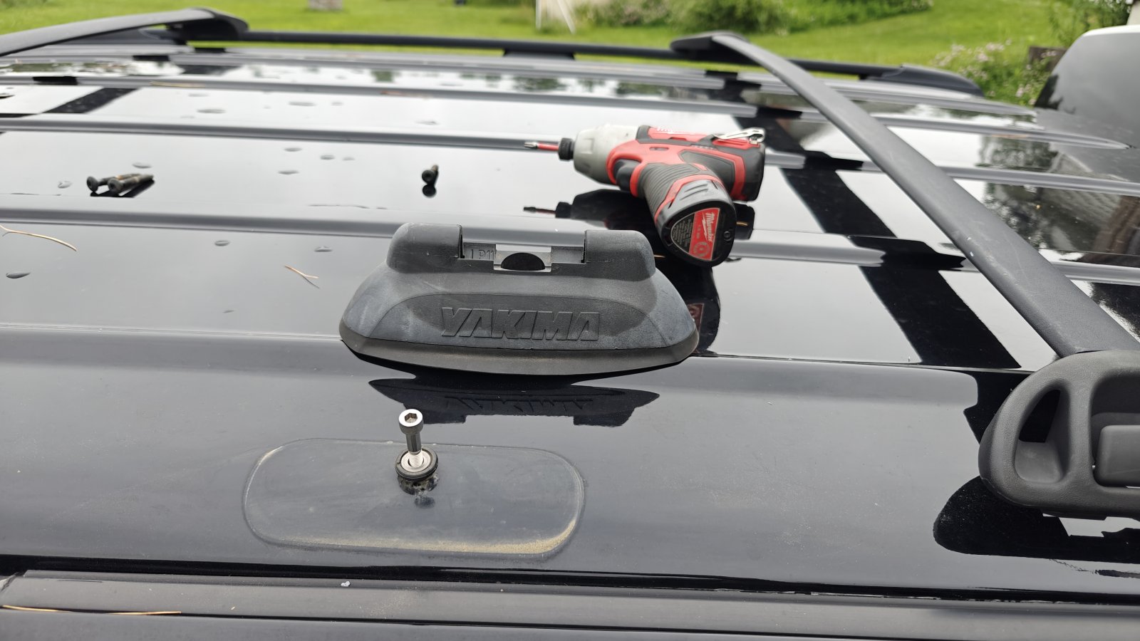

I will be drilling the Yakima rails to match the Tahoe's fittings, then spacing the bars depending on the load. I am doing it this way to have the maximum number of fasteners into the roof (without installing more) and to distribute the load as much as possible. I strongly suggest being careful on loading while using just one fastener, as it could pull out or bend the roof quite easily. I'd instead use the pad areas that have two fasteners.
Also, make sure you seal the fasteners, as the nutserts (or whatever GM calls them) are open, not blind. I'll be using Strip-Calk.

For now I'm hoping that kayaks won't be an issue utilizing just one bolt/bolt-hole. I guess I'm thinking that it worked fine on my BMWs with one hole per tower.
I didn't have any sealer, per se, so I used some blue gel thread-locker that never really hardens completely. It's a fail for locking threads, but will work well to seal them. I was going to use a layer of teflon tape, but somehow can't currently find the 40 rolls I've accumulated over the years.

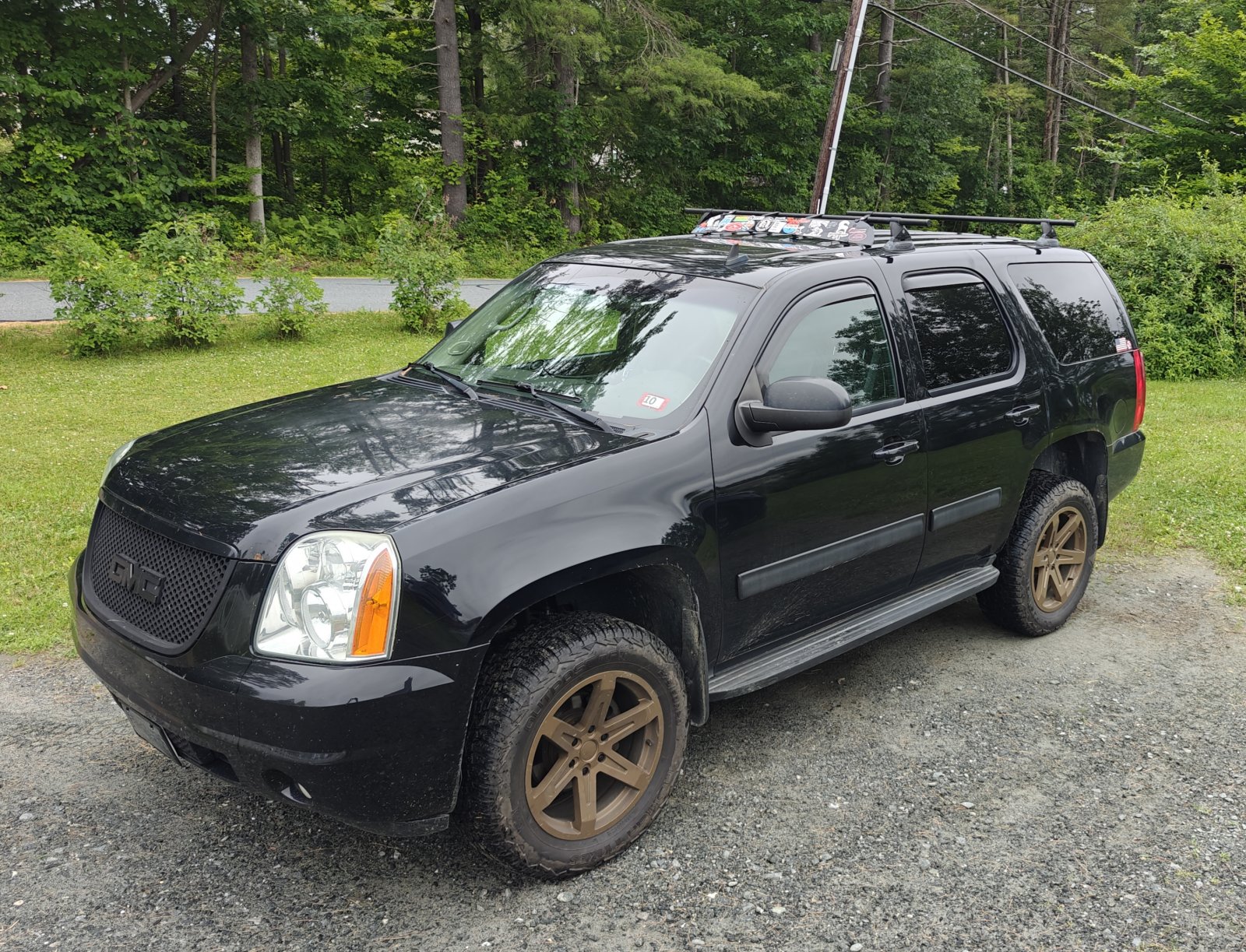

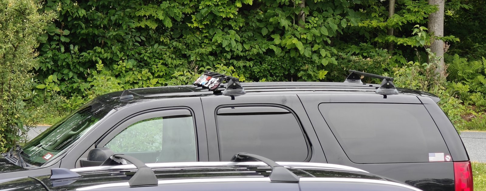

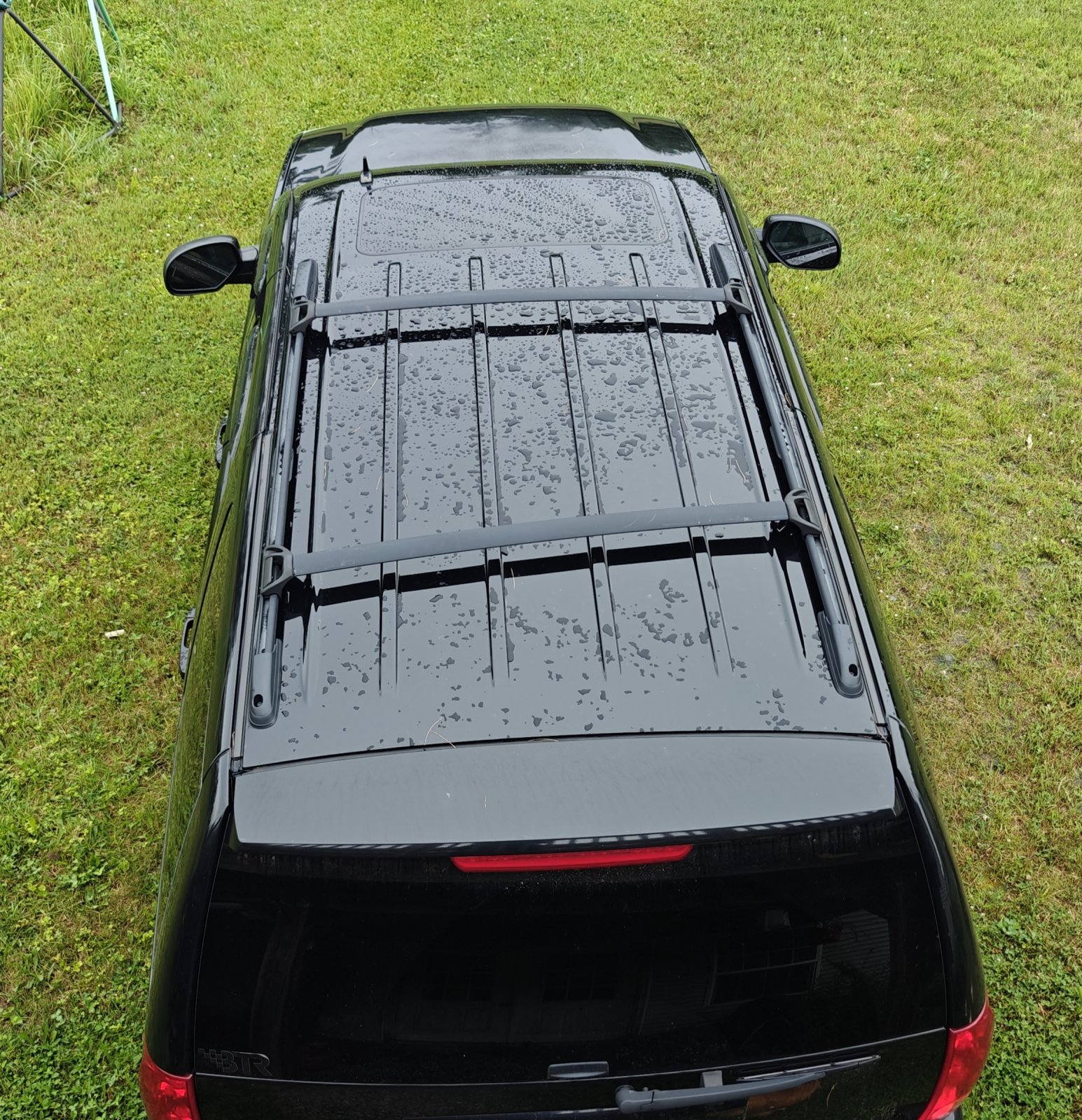

This is what I ended up with. It seems like adding a plate in the front and back, under each tower to utilize the two bolt holes in the roof would be a good solution, but I'll have to mull over how to find the right materials.
Adding a 3rd set of towers and a crossbar over the middle, to use the existing mounting holes in the roof would be nice.

It looks like you have already settled on a solution but just as an FYI the Z71 roof rack from the GMT800 platform will bolt right onto our GMT900 trucks and it is quite a bit heavier duty and has a built in roller bar at the rear to ease in loading things up from behind.
