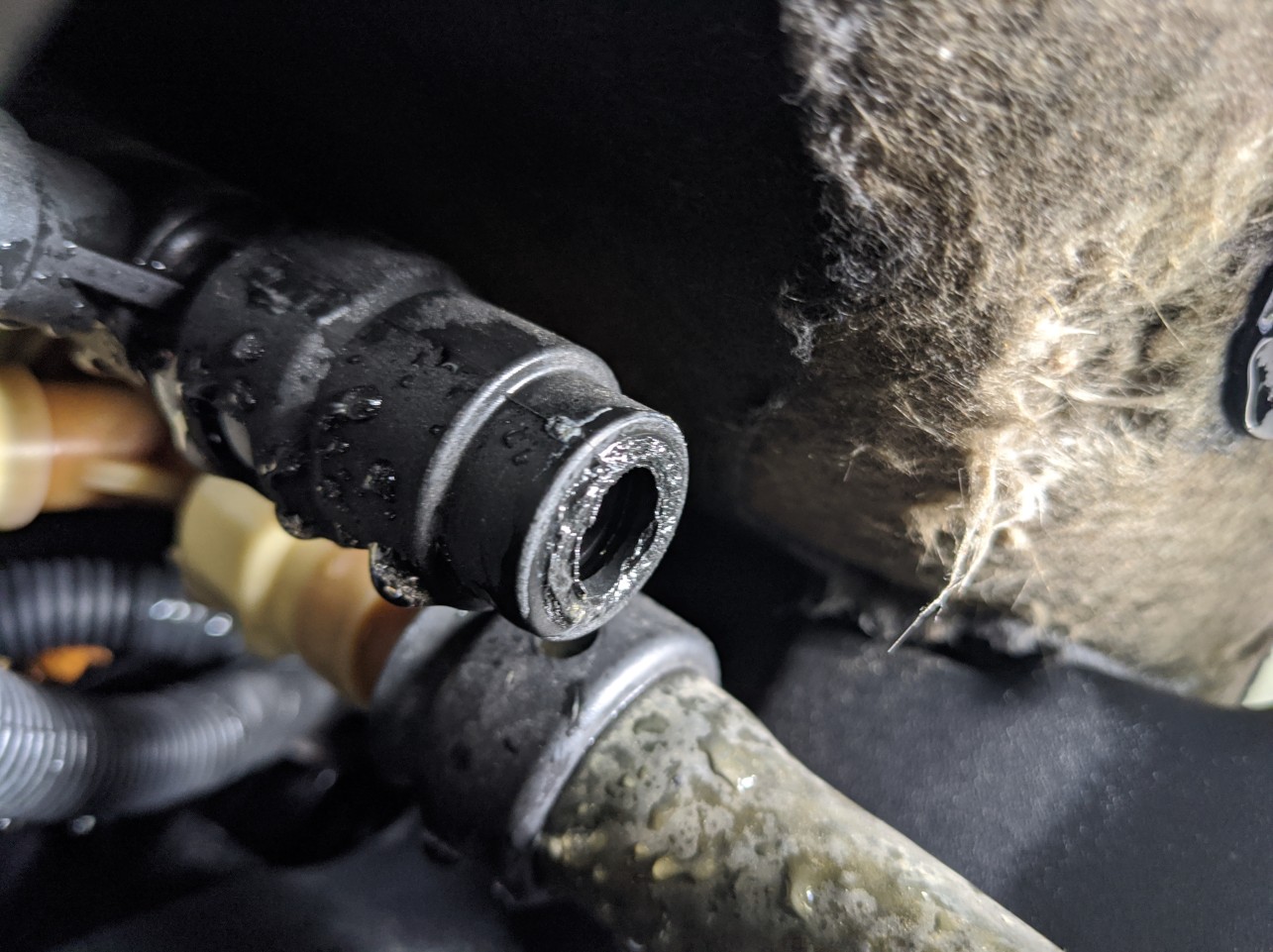

At 148,000 miles, I had not yet changed them all out, and look what happened (fortunately, I was 2 miles from home).

I just replaced both after replacing my alternator and the engine cover bumped the white one gently and coolant started rushing out. Ugh lol. I got the black one replace too while I was under there. It’s a tight squeeze that’s for sure but I got her done. Thankyou for the advice though. Luckily I broke it in my driveway by accident rather than on the side of the road

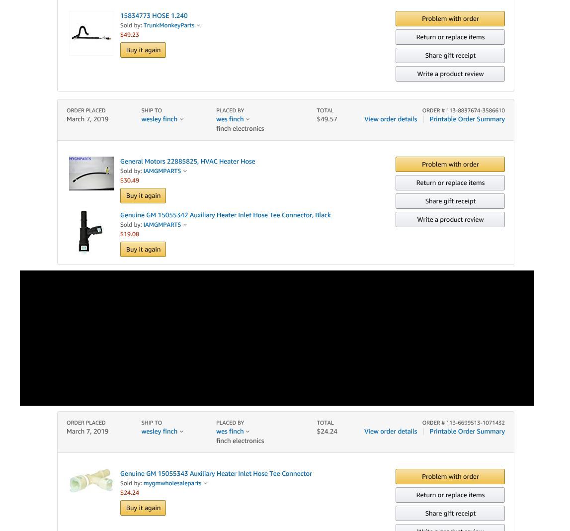

if they were the new design you should be ok for a while. I personally do not recomend them for the heater connections, some people have reported them failing in a year, maybe 2 if not sooner. they are prone to develop leaks from what I have seen but dorman did re-design them at some point
if the part number ended in "CD" that stands for "changed design"
