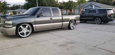

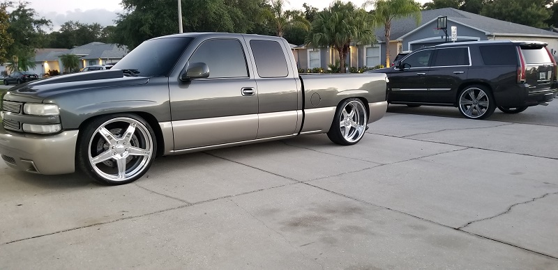

Agree with above comments as well. I added that to the transmission on the 02 Silverado. I don't and haven't ever towed with it but I am supercharged. Nice easy (and relatively inexpensive) upgrade.
Congrats on your latest acquisition.

Hey bro did you say you are supercharged?!! On a 2002 5.3 vortec original engine?
Staggered 02
Jul 5, 2019
672
1,556
Yes sir. Supercharged the Original 5.3. Running a MP119 supercharger, headers, tune, narrowed rear end, Eaton posi, 373 gears, moser axles, and so on.....
