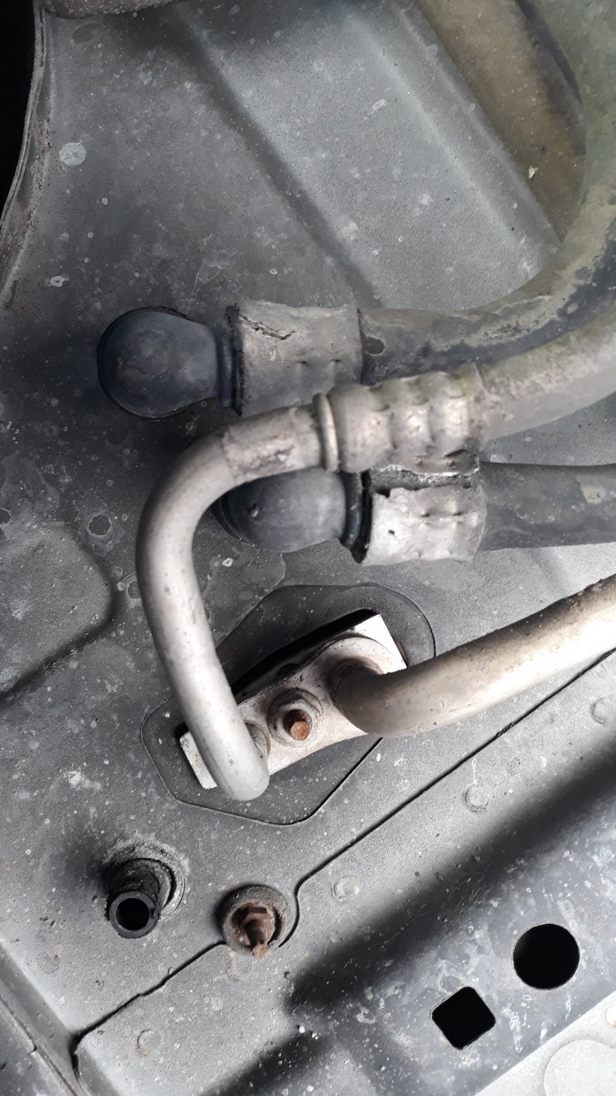

Rear heater lines are easy enough to fix. Here's mine at 12 years and it has been 2 years since:
