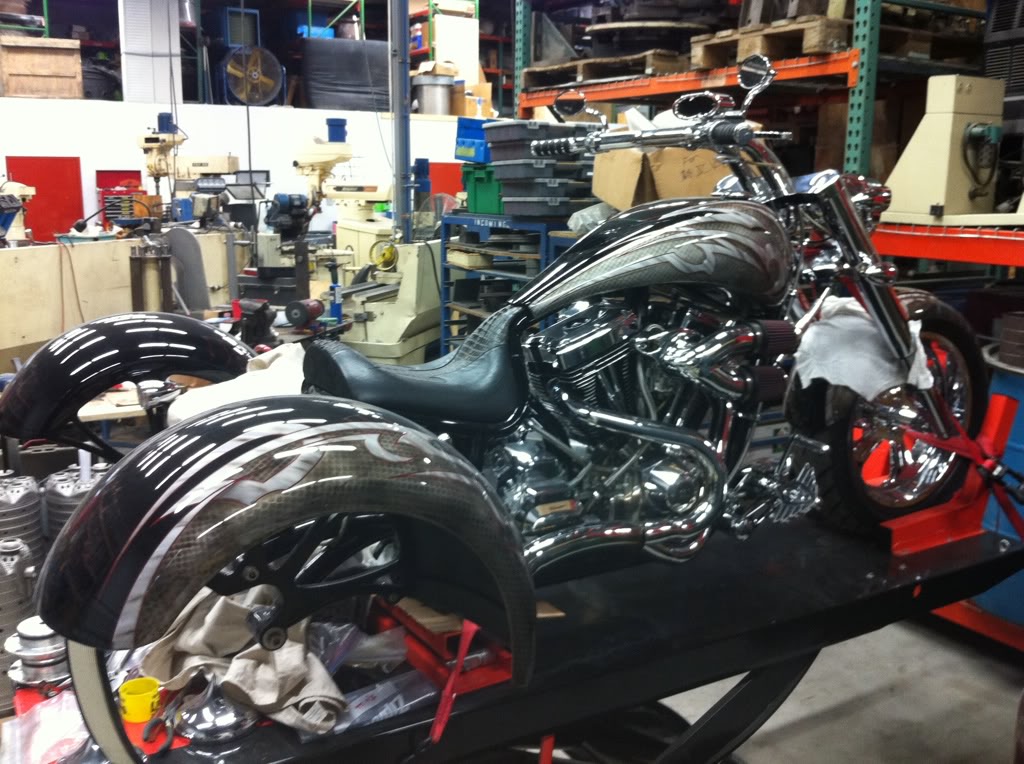

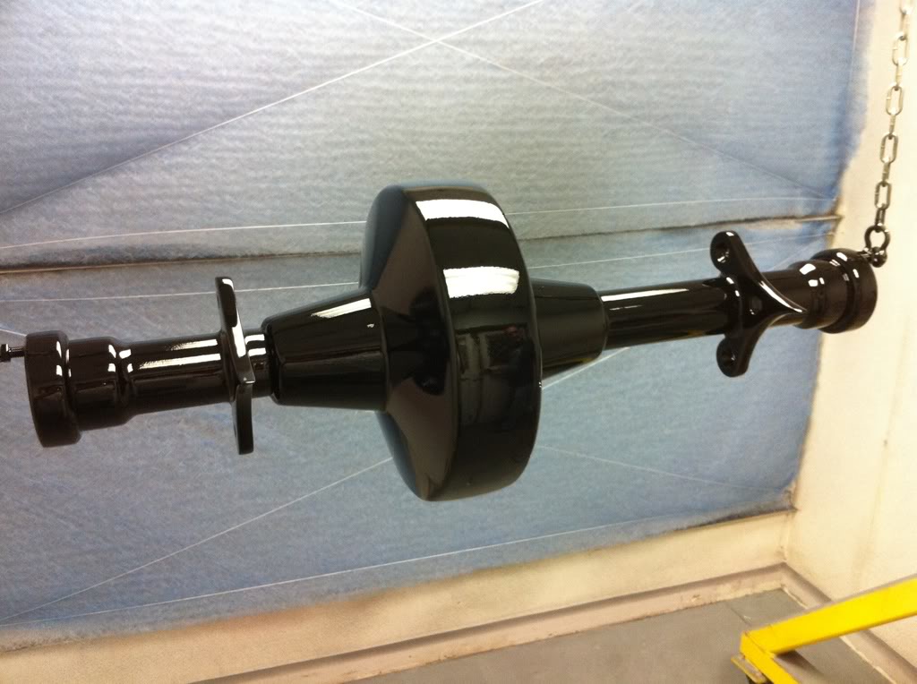

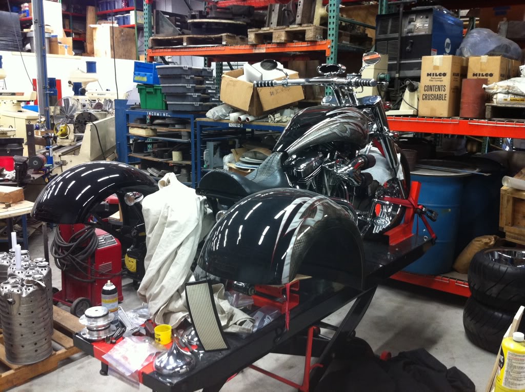

Spent almost all the day fixing the rear dif on our "company vechicle" :) Bourget trike today. Apparently the Germans who made the rear axle don't know how to measure correctly for an axle shaft and made one a little short. Which worked fine for awhile until this past weekend she decided to give way. So after a day of figuring out what the problem was, rebuilding the dif with new bearing, a little bit of a shave and a tuck there, the axle should be ready for paint tomorrow.

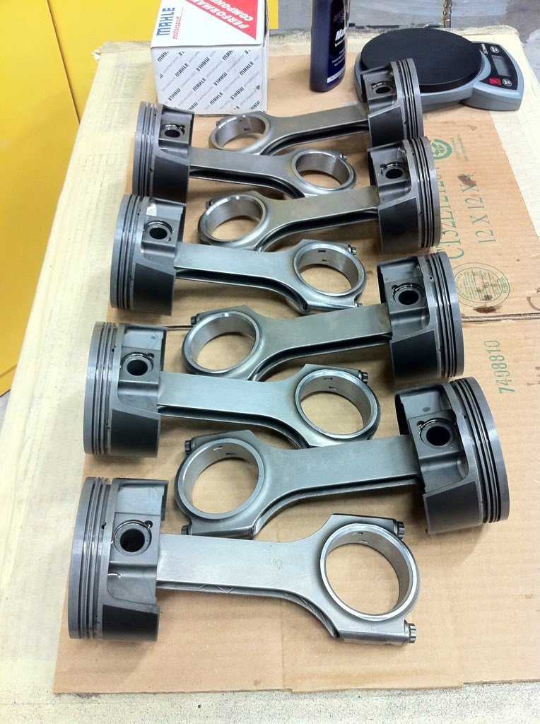

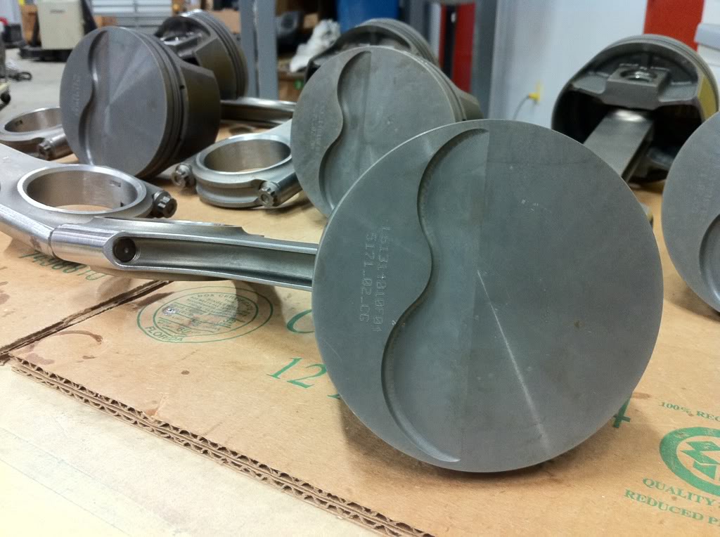

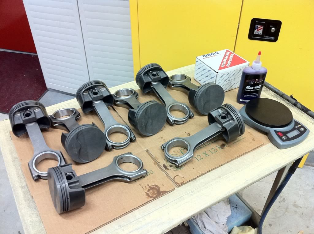

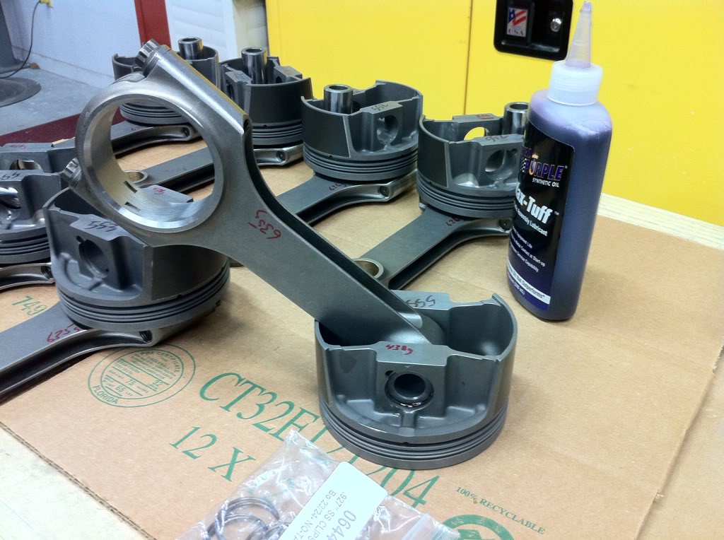

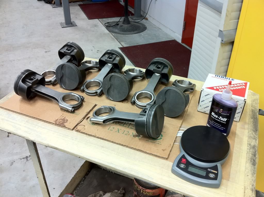

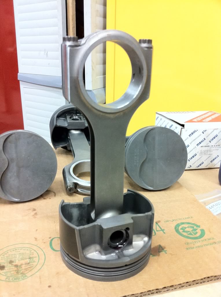

Put in a few hours today cleaning the Crank and assembling Mahle pistons & **** rods. I took it one step further and perfectly weight matched everything. All piston/rod sets weigh in at 1191 grams exactly +/- .5g error, so she should be a smooth runner

How did you make them all weigh the same? Did you find the lightest one and shave weight off all the others to match? I've never done it before.
The rods can be shaved on the sides by the crank journal/bolts and on the top by the piston pin journal. The piston can be shaved on the bottom inside along the supporting structure of the piston, but not digging into the piston itself (getting closer to the face of the piston). When I had the block machined .020” over and cleaned, I also had the shop go through the pistons and rods. They had the weight down to 2-3 grams difference between rods, and a 1-2 gram difference between pistons. So just to satisfy my OCD I tightened that difference up a little and paired them appropriately. They would have worked perfectly well, but I want this engine to purr, so I might as well take the time now and make it perfect.

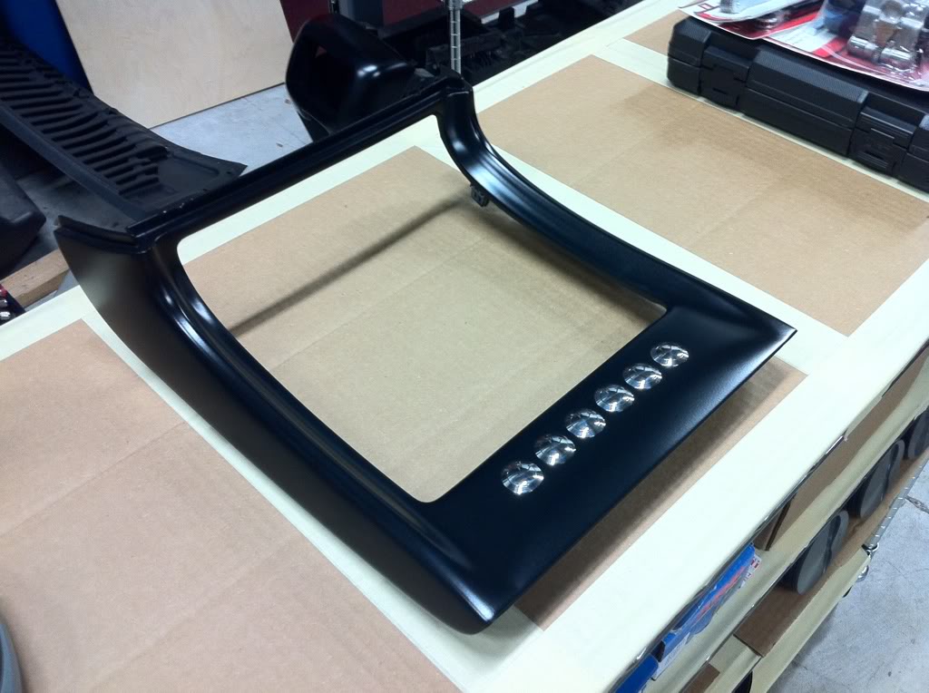

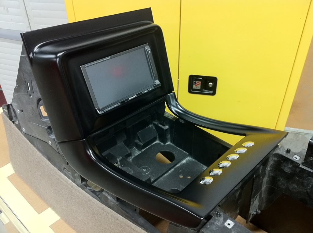

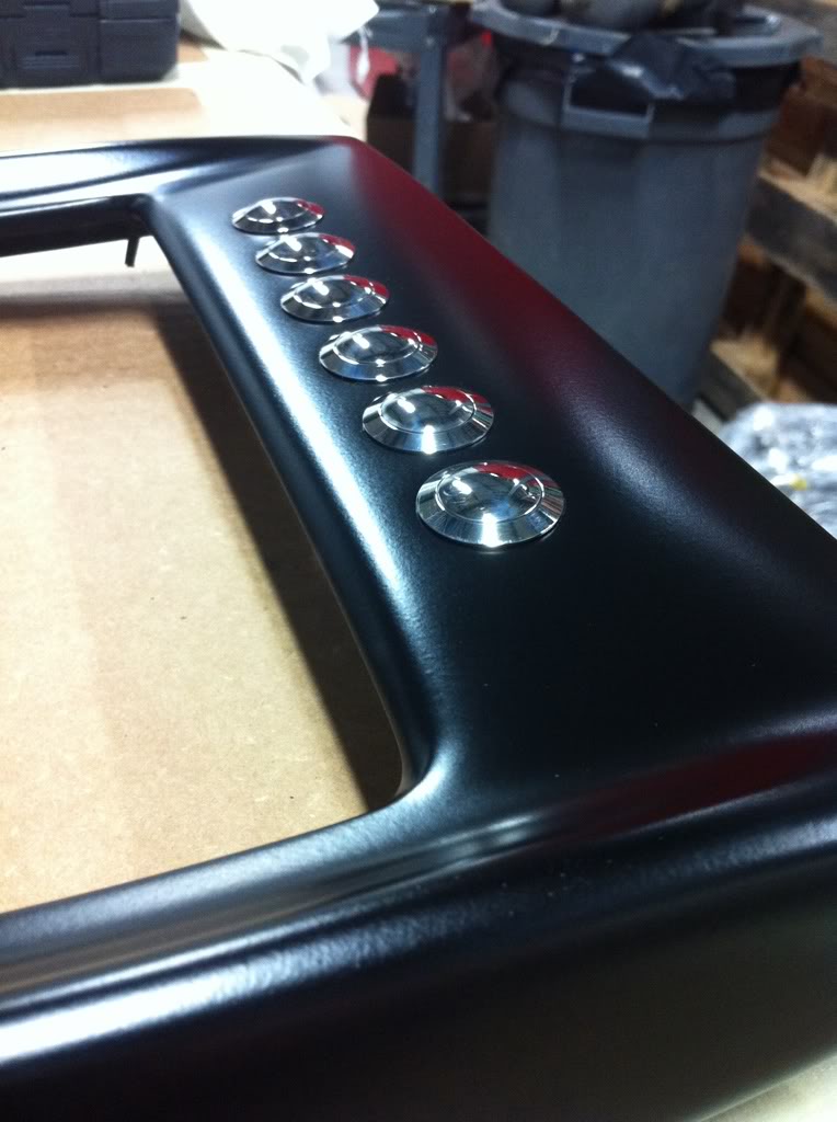

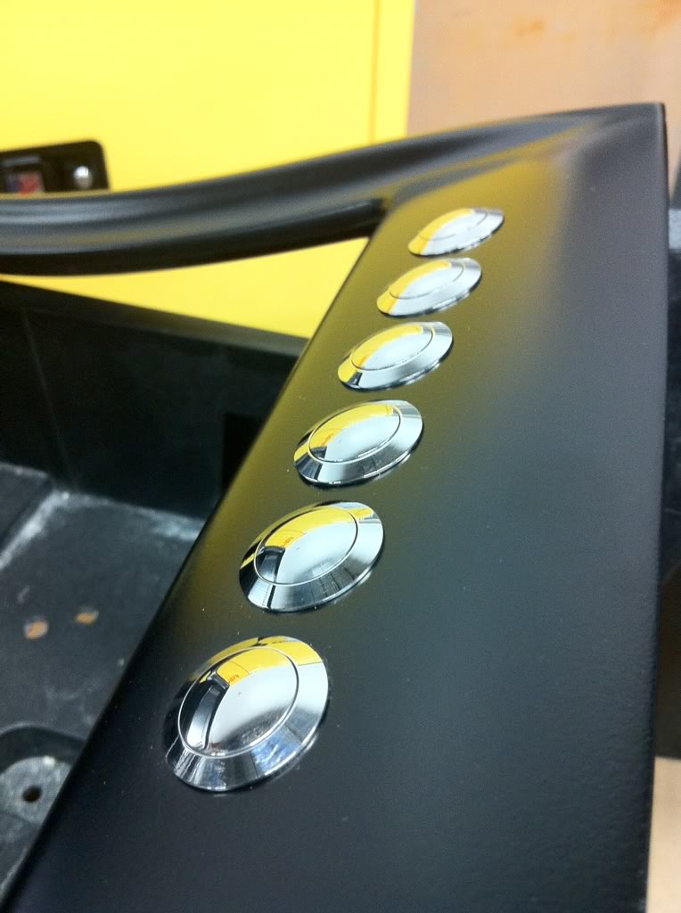

Alright I’ve been hung up a little with work and fixing the rear axle on the trike. But today I had a couple hours to work on the center console and some seat pieces. I spent about an hour or two polishing up the buttons and adjusting the fit in the piece that holds them. The buttons aren’t locked in yet, I have to wait to build the cup holder portion back up with its springs and covers then epoxy it back to this piece. But this week I should bust the black leather box open for the side for the console.

Looks good! :waytogo: I'd have a hard time remembering what each one does :D

Thanks E. At $12 a piece they better be. They are industrial grade stainless buttons rated at 8 million cycles, so I won't be replacing them anytime soon.
07: From left to right
Drivers door
Pass door
Rear driver
Rear pass
Hatch
Hatch Glass
Sorry no labels allowed...
And each door will have its own button.
50,933
19,327
Interesting. I'd have to make up labels which would just ruin the whole look! :)
