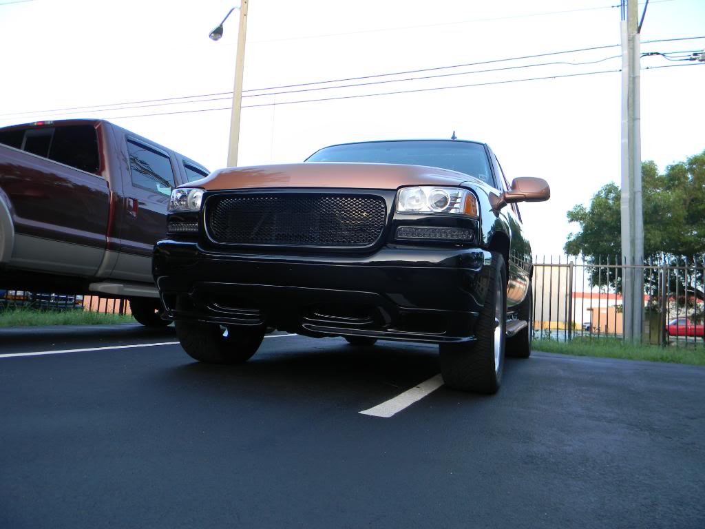

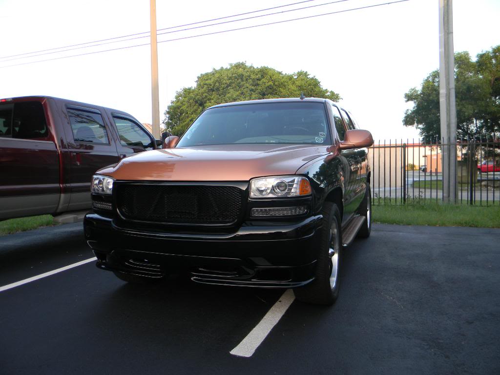

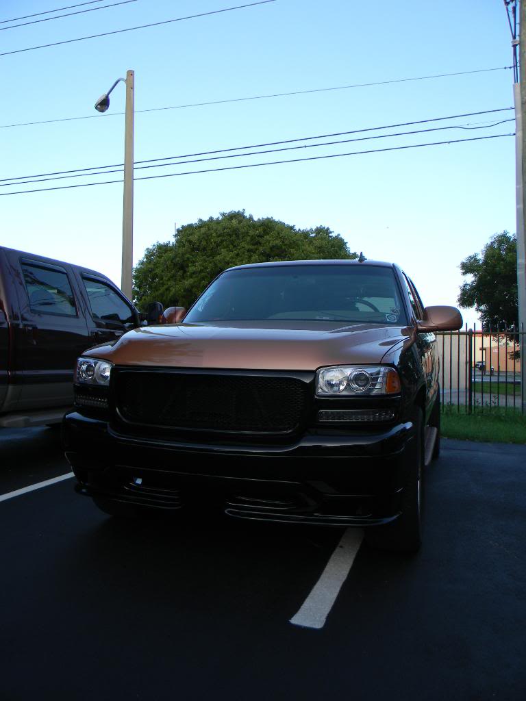

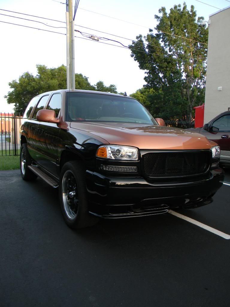

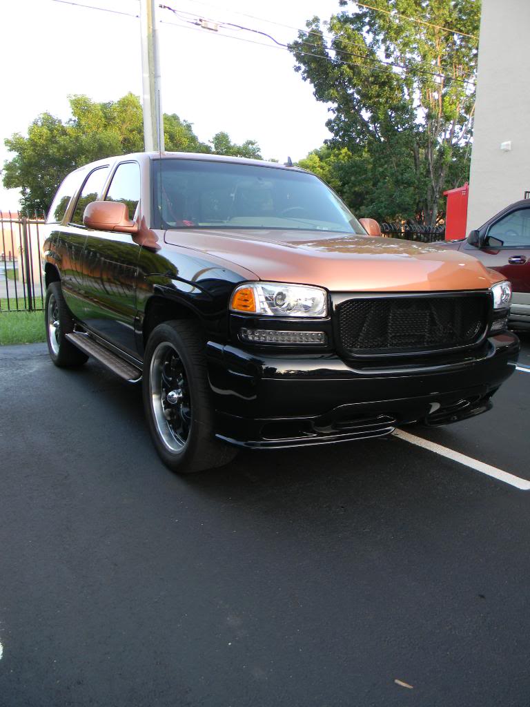

On another note I bought a 12MP Nikon point and shoot for the Shop and decided to take a couple shots of the Kon before the sun was fully up for some nice light. Here they are...
(Photo Bucket reduces quality but they still look nice)

Nice man, that damn thing is lookin SLICK!
You need a stubby antenna lol

I have one already, just haven't put it on it yet. I might even get rid of the Antenna all together. I can't remember the last time I listened to regular radio.

I love your build thread...and your truck
I have to be 100% honest though...I'm not a fan of the grill...it looks like its missing something...and its so easy to see all the ugly shit behind our grills =/
2nd to last picture doesnt even look like you have a grill in..because of the angle...
not knocking your truck...I love everything you've done to it...its just somethin specific that I dont care for too much...cleaner then mine still though

That’s alright to each his own, Black wheels, Red wheels, whatever....:secret: Haha, Just playin...

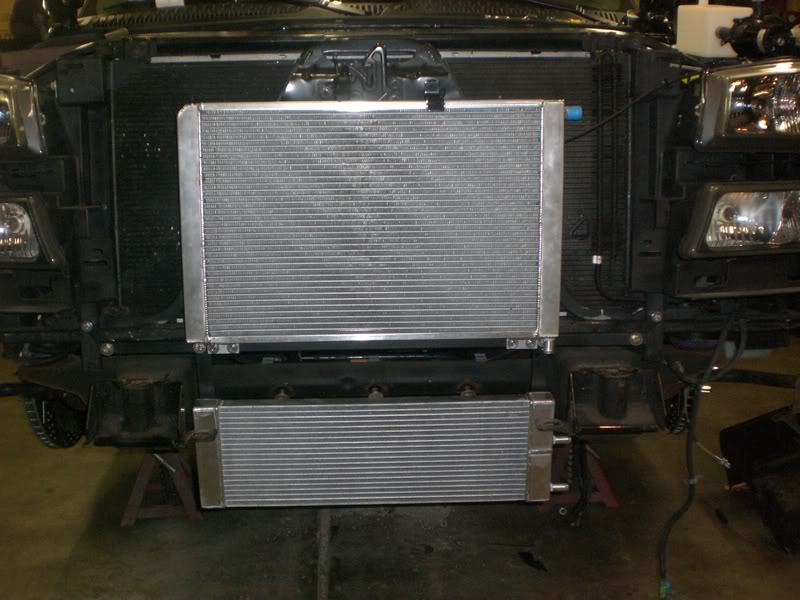

But don't judge before she's complete, Behind that grill will go the intercooler for the magnacharger. To give it a little dose of "mechanical beauty” and in my mind should look sickkkk when she's all done. I think the grill is perfect, gives it that wide open mouth look I love so much on Astin Martins, Jags, etc, and when viewing it from straight ahead it will give you a nice hint at what’s inside.

This is similar to the setup I will be running, but I won't have the little one at the bottom.

The HD Hood looks good with the completely painted bumper and grill assembly.
