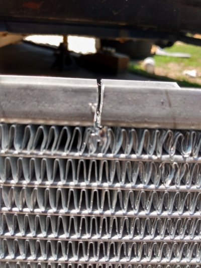

Well, got the new radiator, :happy107:.

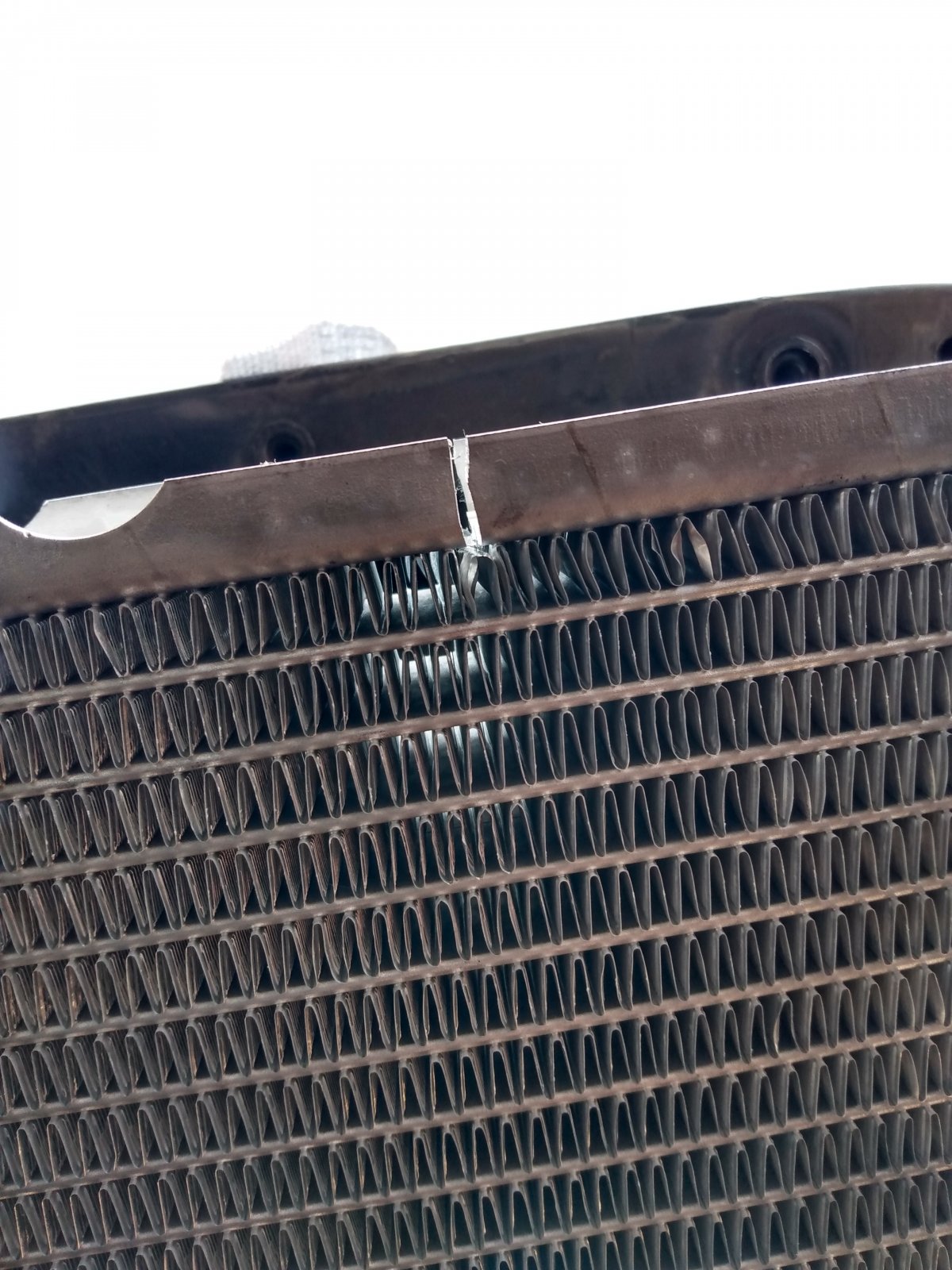

Took everything out and was setting the new one and saw the top channel is cut through into the cooling fins, :favorites68:.
Now I'll be waiting until Monday for a new one to be shipped:(.

Here it is

I was seriously debating about just installing it and taking my chances but, I'm just going to wait for the new to arrive.
I really don't want to do this twice.

i went out and double checked mine is cut like that as well, it's a thermal expansion cut, normal.

Really?
Well, if that's the case. Then all is well :)
Holy s**t I thought I was having a really bad day.
Thank You, I can go wrap things up now.
This sucks.
I had sent them an e-mail before posting in regard to the cut.
They want it back. They said a new one is on the way but reiterated they want it back.
I had called because I wanted to speak to a tech but they do not have any techs on hand and again, stated "they want it back, it is not supposed to look like that"
Now I have to pull it out again. Seriously wtf.

have they already sent a replacement? if so just give them the replacement one back when it arrives
They said they sent it already.
That's my plan.
I was just outside putting my new windshield washer tank in inspecting my brakes and wrapping things up.
I do have a question. Why do factory radiators not have this cut?

no idea, this one is a little thicker and it's aftermarket, might just be a extra measure they took to prevent any problems
Go figure haha. I'm curious if the PPV models have the same radiator because it was the same size as my factory one.

Shocked, my "replacement" radiator showed up this afternoon.
Same cuts in it as the one I installed.
I will say I'm impressed; they don't mess around with their shipping. Not even 24 hours later and it was at my door.
