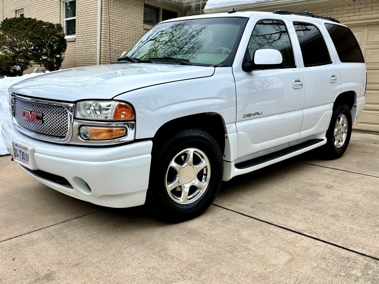

Hello, I have a 2002 Yukon Denali that I bought from the original owner in Alabama and have been driving for the past 19 years and I really like the vehicle.I have been thinking about updating and purchasing a 2018-2020 Yukon Denali Ultimate. Since I keep my vehicles for a long time I want to buy something with lower mileage and one that has really been taken care of. I know that is hard to find. But I will wait until I find the right one.
I have read lots of horror stories about the engines and transmissions, but everytime I ask someone who I see driving one, they alway say it's great no problems.
So please help me out and give me some things I should be looking out for, and any advice is appreciated.
I have attached a picture of my 2002 which I hate to sell, but I really like all the new technology in the newer vehicles.
