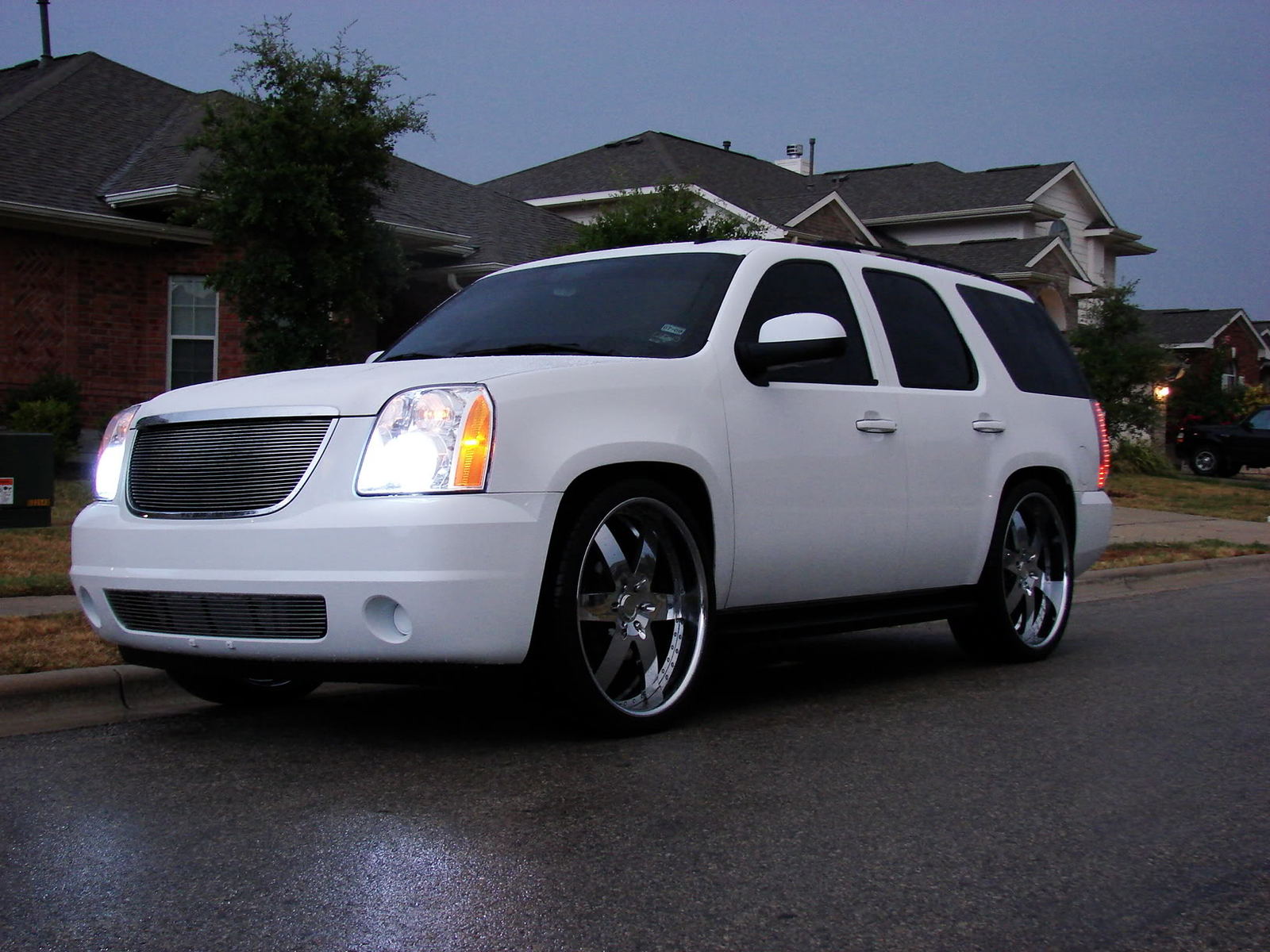

Here are what 8000K HID bulbs look like...
