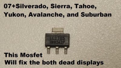

Hey guys, the other night I was driving at night and decided to adjust the level of brightness of my dash components….when I did this, I could smell that something had blown and now my computer display doesn’t work….any thoughts or advice on how to fix it?
kbuskill
Mar 11, 2017
5,822
9,833
NE. FL.
If you are handy with a soldering iron grab this and watch a couple videos on YouTube.
If not, there are places that will repair your cluster on Fleabay for around $60.
