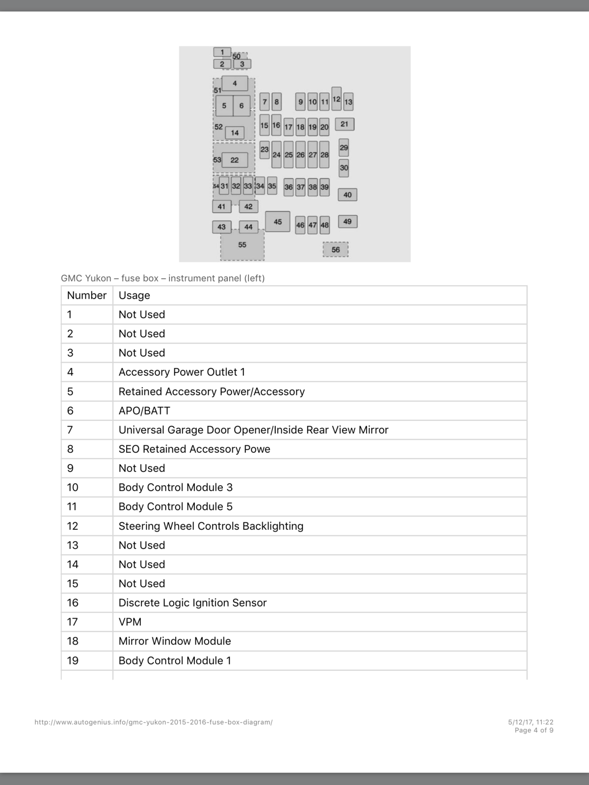

Screen shot?
There you go, a free-thinker, you should be banned...
Actually, a dang good idea.

Now, hopefully, this is what was needed. Not just a re-hash of old/irrelevant info...
52,956
Unfortunately it looks just what he was saying- instead of finding the fuse for the right rear turn signal, it just shows BCM6 in the right dash fuse box. He was trying to find out what functions that fuse protects.

For that, he may want to look at the wiring diagrams to find the BCM, then follow it to turn signals and such. And, maybe, trace out that particular fuse wiring.
I cannot help more than that at the moment. Sorry...

Another screenshot...
Upper right, you'll see F46DR. This is BCM6 fuse and it feeds from the BCM, through the underhood fuse panel, to the right rear light assembly.
