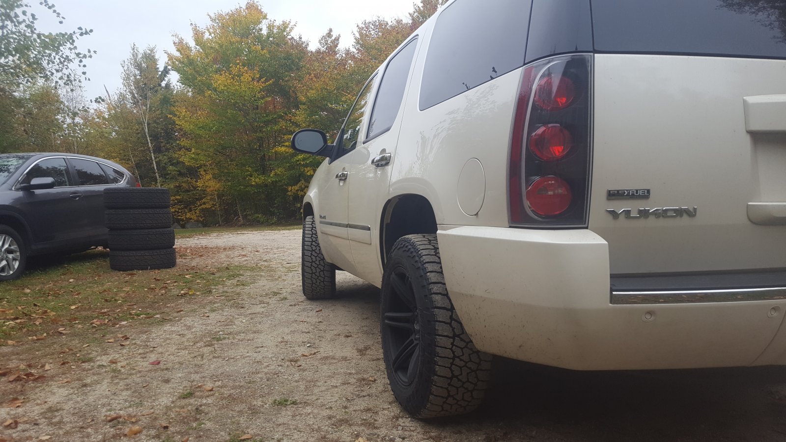

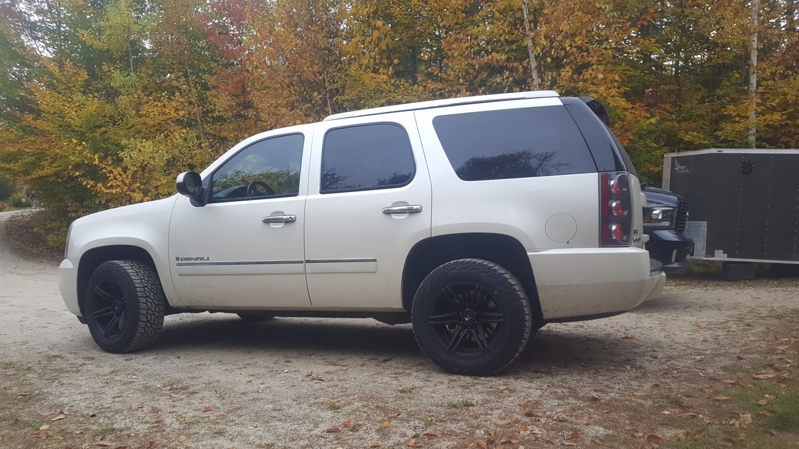

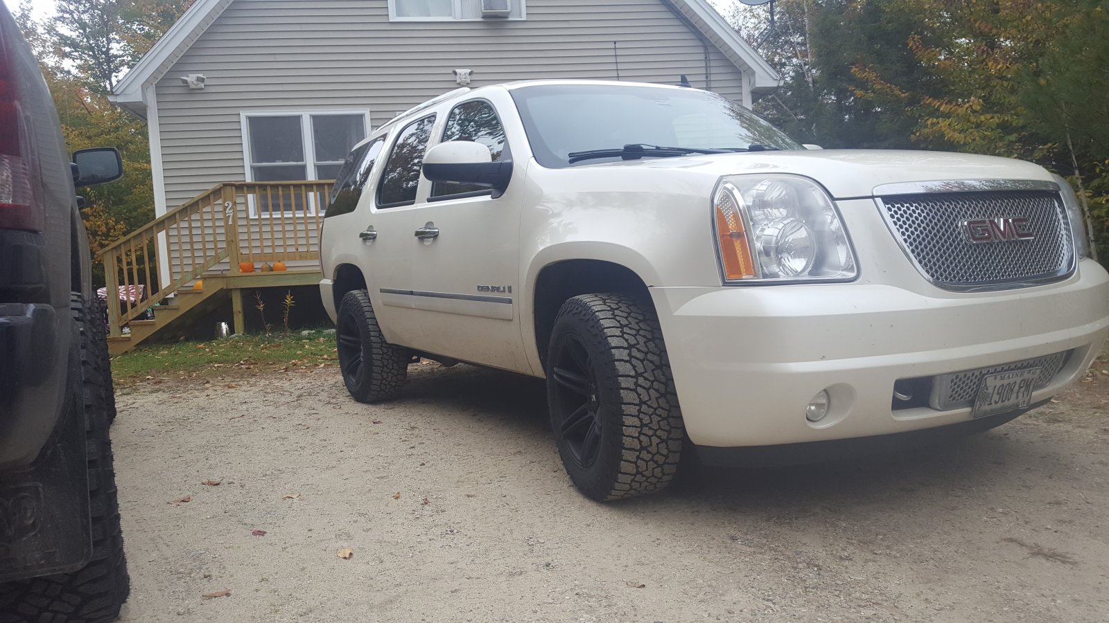

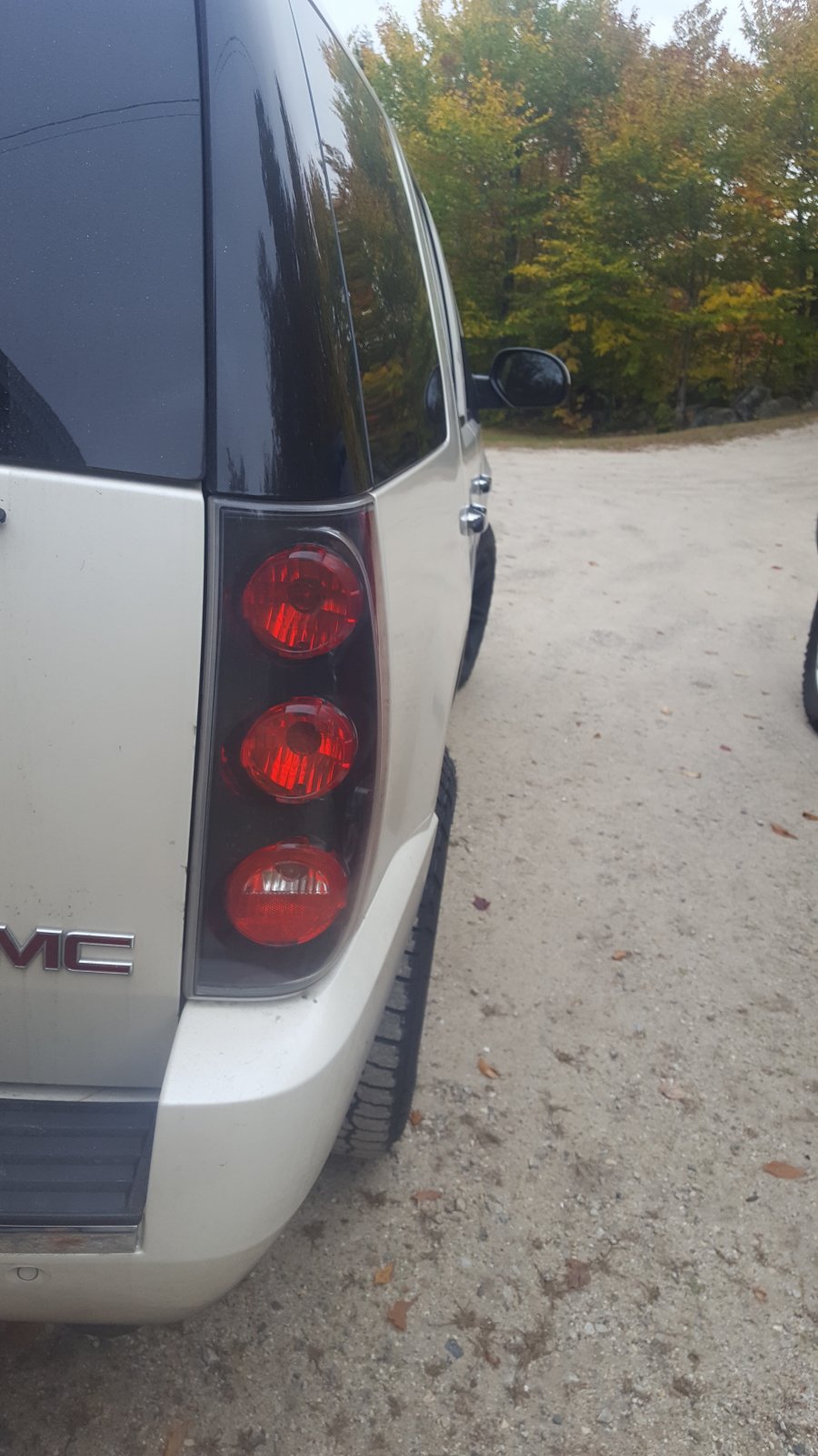

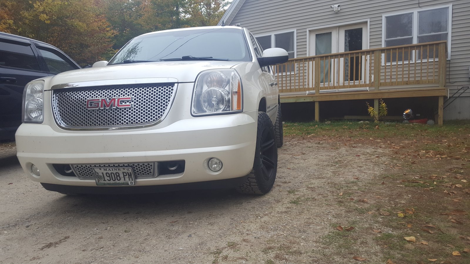

thought i would update this thread. finally got the wheels and tires installed. i dry fit a wheel to make sure they were the correct ones (once a tire was mounted i would not be able to return them if wrong). i was a little worried that they stuck iut a little too far. it looked like the wheel was past the fender maybe a half inch.
now after they are installed i love it. the look i was looking for. went from a nice city denali look to badass offroad look. more my style. just looks so agressive. pics dont do it justice.

I think they look great! Definitely do not stick out too far.
