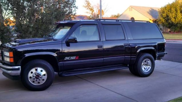

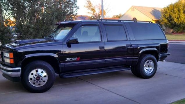

I have seen some Jerry Rigged old Suburbans with a dually conversion. But again, the wheel hump interferes with the rear door. Folks have just added the dually fiberglass wheel flares and it looks funny. A longer wheelbase would solve that issue.
Speaking of which, my buddy has mentioned that there's a company in Oklahoma that apparently takes Excursion bodies and swaps them into newer F250 diesel drivetrains. He jokes that I should buy one of those for hauling my kids (we have a lot of kids.) The "only" problem is the conversion costs like $60k or something like that.
Edit: I think this must be the place: http://www.customautosbytim.com/
