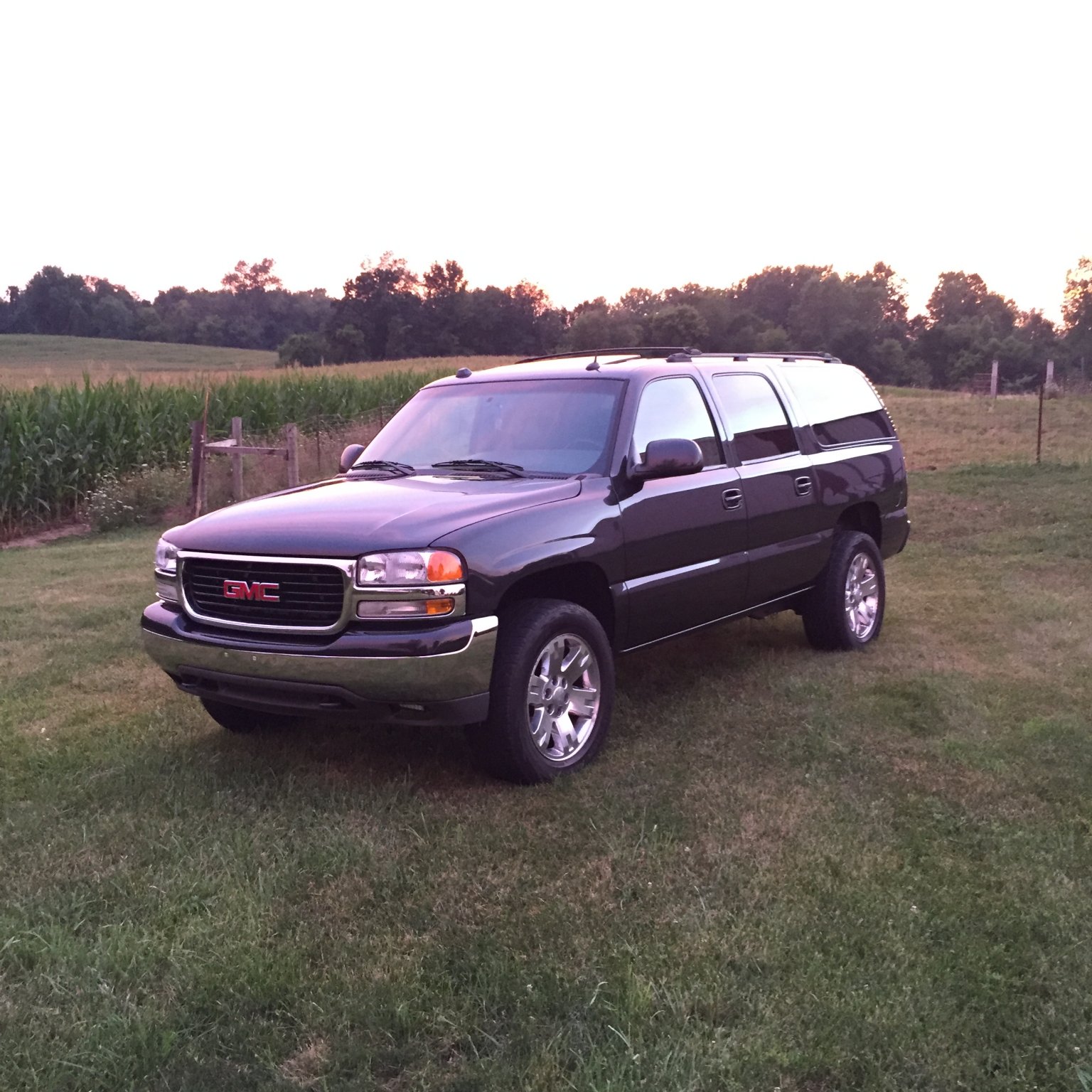

eBay keys in the front, stock springs in the rear with eBay 1.5" spacers. Sitting at 39.25" in the back and 38" in the front. 275/60's on OEM 20's with 1.5" wheel spacers on all 4 corners.

Looks perfect but I'm not a fan of spacers have you had any issues with them?
Countryboy07
Apr 17, 2015
892
800
Nope, no issues whatsoever in the 15,000 miles they've been on so far.
