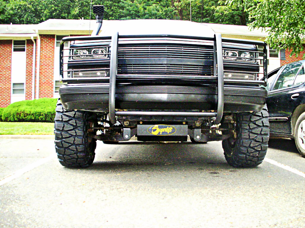

My cv angles are in the pic below , i bought the 6.5 inch kit but I'm sitting at 5 inches at the moment with a negative crank . i did have to trim a bit
