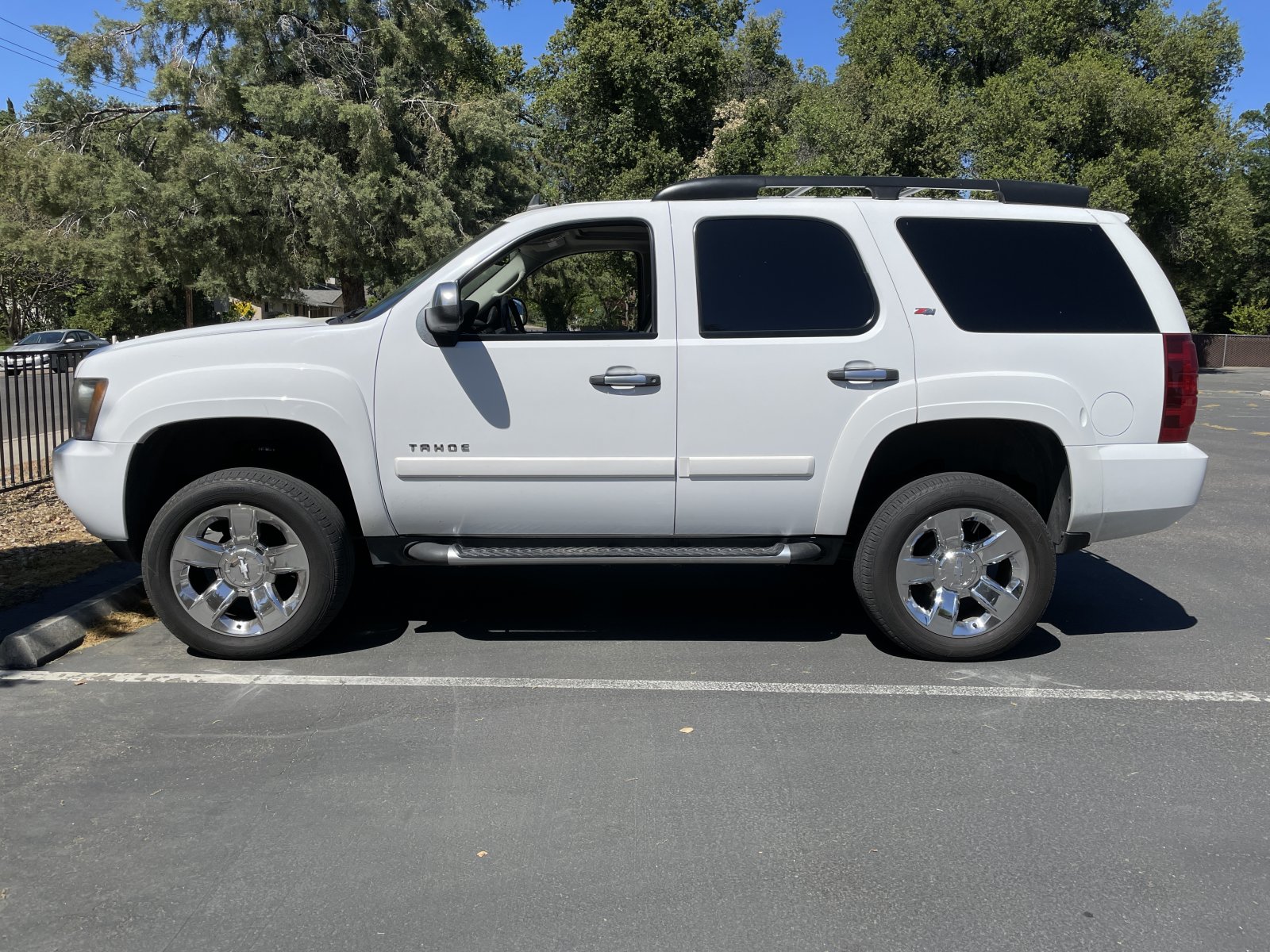

@whee I have the same setup that you are describing so allow me to shed some light on the situation.
When using the 81244 springs in the front set the bilstein 5100's to factory height when you assemble them and you can use the 2.5 inch spacer just fine. But this will result in the front of the Tahoe being about 2 inches higher than the rear and it will look terrible.
I would at the very least add a 2 or 2.5 inch spacer to the back to keep the stance level looking.
Keep in mind that once you are this height your suspension is stretched and you will probably want to get aftermarket upper control arms and an adjustable pan hard bar to get everything centered.
Take a look at my signature and let me know if you have any specific questions.
Here is a picture of my Tahoe with. Front: Bilstein 5100 (factory height), MOOG 81244, and 2.5 inch spacer | Rear: MOOG 81069 and 2.5 inch spacer

whee
Feb 28, 2021
Thanks Dustin! Your rig looks great.
I think I’ll look at different front springs. I don’t want to go up that much. Most I want to do is 1” at the rear and I’d like to keep a bit of rake so when I have my typical load I’m still mostly level.

@whee That is probably a good idea, the setup I have is very firm
