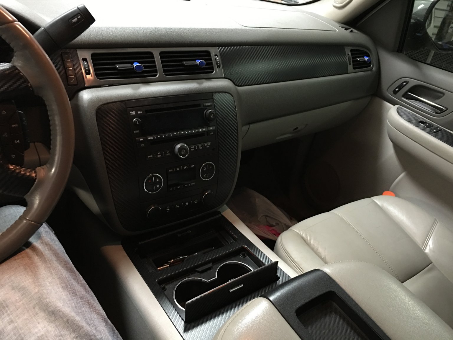

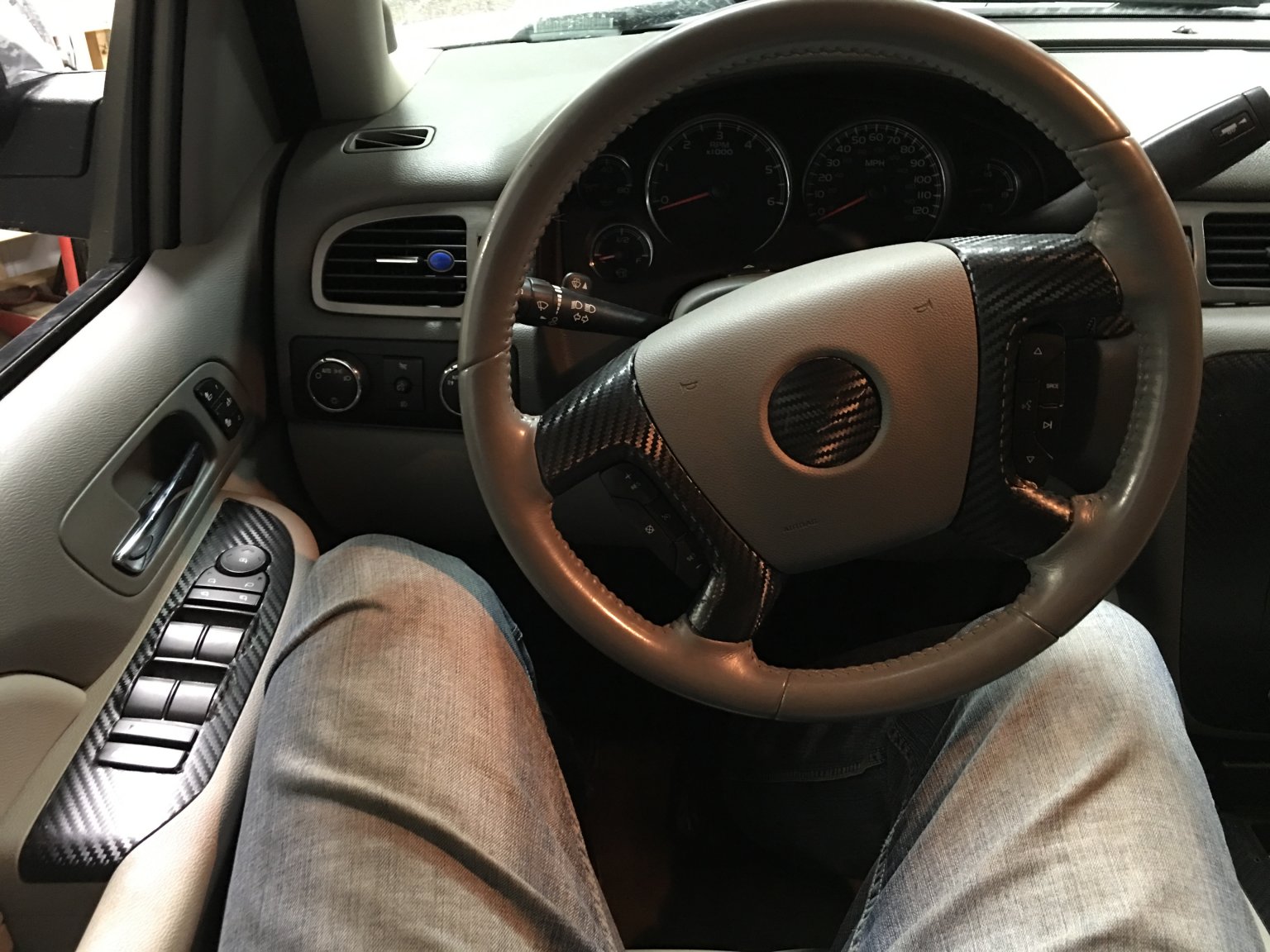

I got around to wrapping my interior this last week... Looks much better. View attachment 58218View attachment 58219
Now, do I completely get rid of chrome for all black?View attachment 58220
Get rid of chrome, no one likes it, lol I"m jk I don't like it. I'm debating on doing as well. I have the same set up as you and I'm pretty sure that its the aftermarket sticky on chrome for me. Looks like you have the same stuff. I'm just hesitant on doing bc the plastic underneath can be tarnished and ruined from anything that may have been sitting there for how ever long the chrome has been on as well as getting the two sided tape of is hard enough as it is that being on plastic is even worse bc you can not use the same type of ways getting off the tape and glue as you can on metal or painted surfaces. The two sided tape can even ruin the plastic all together. If it does mess up the plastic you can always repaint with factory type rattle cans that make the plastic look new. If I do remove them it will be this summer when its a little warmer out side. Heat always makes things like this go faster when removing two sided tape.
Your interior looks good by the way. Especially like the steering wheel. I was looking at painting all the same parts as you covered and after seeing what you have done I may just wrap in black vinyl or another color. Even tho I'm no big into carbon fiber look this looks pretty good.
