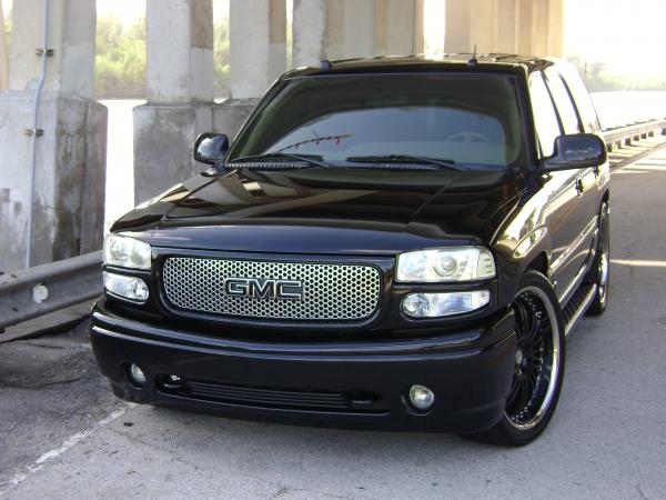

BlackDenali
Roof Rack ****
Jun 11, 2009
1,801
Boca Raton, Florida
Yes Sir.......
