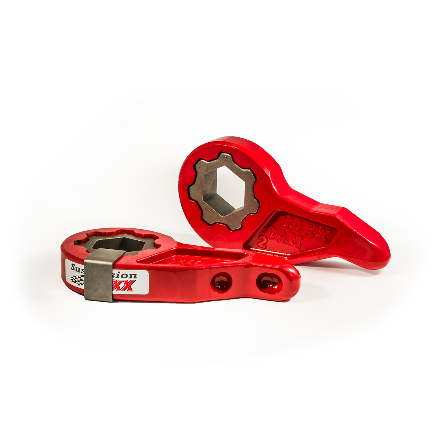

Stock torsion keys cranked up or aftermarket keys? I think I read aftermarket keys uncranked.
Can someone post a link to some that would work for my application? Thanks

Aftermarket lift keys uncranked or maybe halfway up with 2-3” shock extenders should be fine that’ll give you clearance to clear 33s and cranked up clear 35s on stock wheels

The torsion key kit you linked will work to level your front end. You may not even need the shock extenders, however...

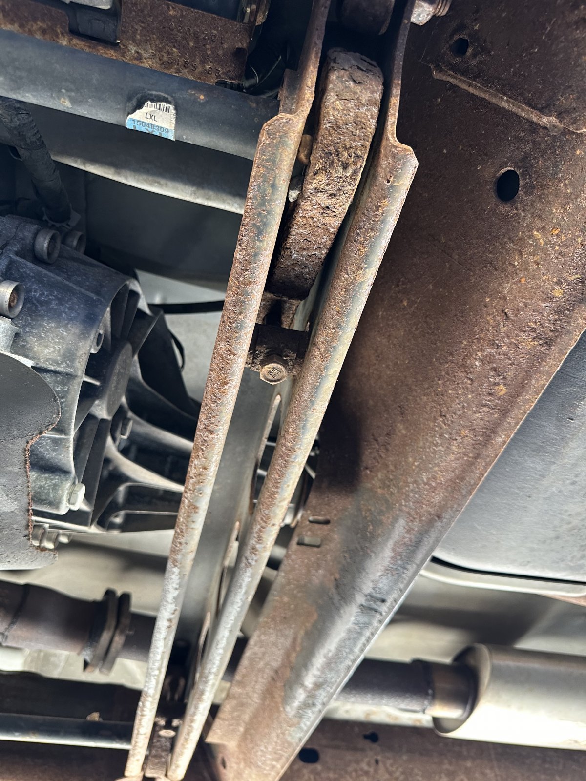

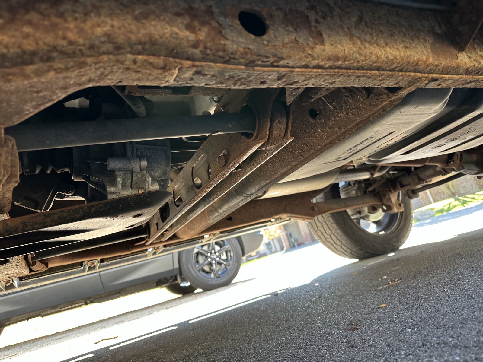

Also is it possible to tell if the torsion bars are cranked from these pics? When I purchased it 7 years ago the guy was running 275/60r20 on it so he might of cranked them before. I’m just not sure how to tell exactly

Spoke with 2 shops today that said they actually wouldn’t even touch it with the chance of the keys being rusted in. How bad does this rust look? Or is it just surface rust.
Also for front end leveling was told that I’d need to change the upper control arms and one shop said he’d just leave it alone if it was his because it could turn into a real mess
