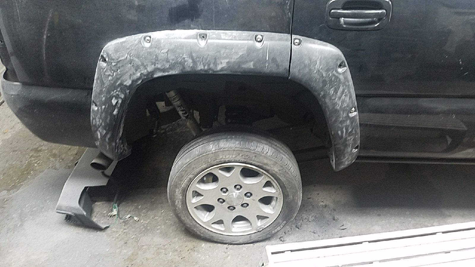

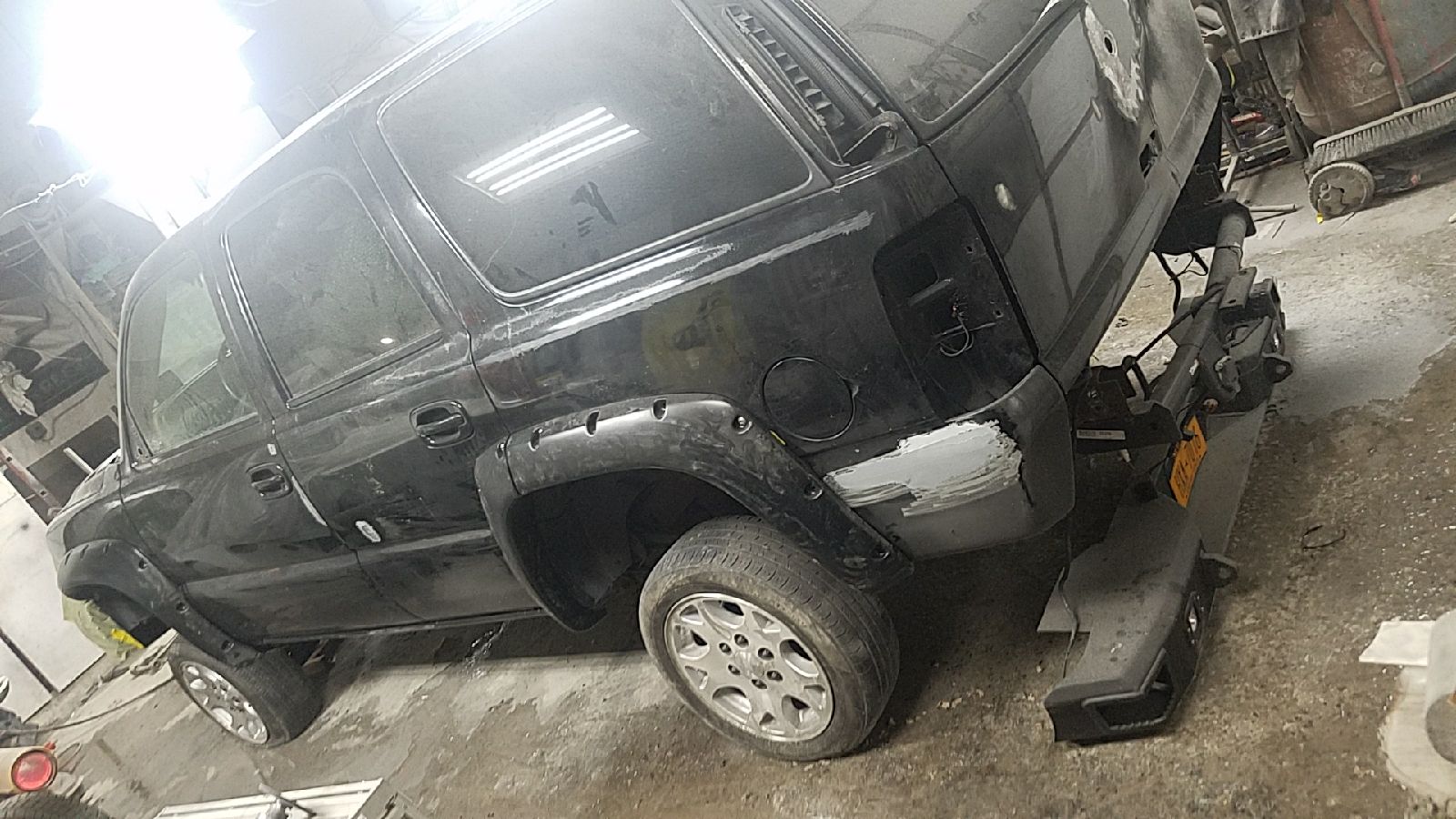

Following up on this so folks searching for info regarding "pocket" flares on a Tahoe can find it all in one place.
So the Tahoe is at the body shop and the Bushwacker flares have been mostly fabricated. Instead of enlarging the wheel well (as per the requirement for "cut-out" style flares) they just modified the flare itself. Since they already had to cut the flare at the intersection of the rear door and the body, it was easier just to trim on an angle to make the flares fit the existing wheel well shape, instead of cutting and folding the fender like the flare instructions called for.
There was a good amount of trimming of the flare to get it to sit correctly, but nothing overly difficult. They did have do some fabricating of the plastic to fill in the hole where the flare was cut in half to ensure a nice clean look when you open the door.
