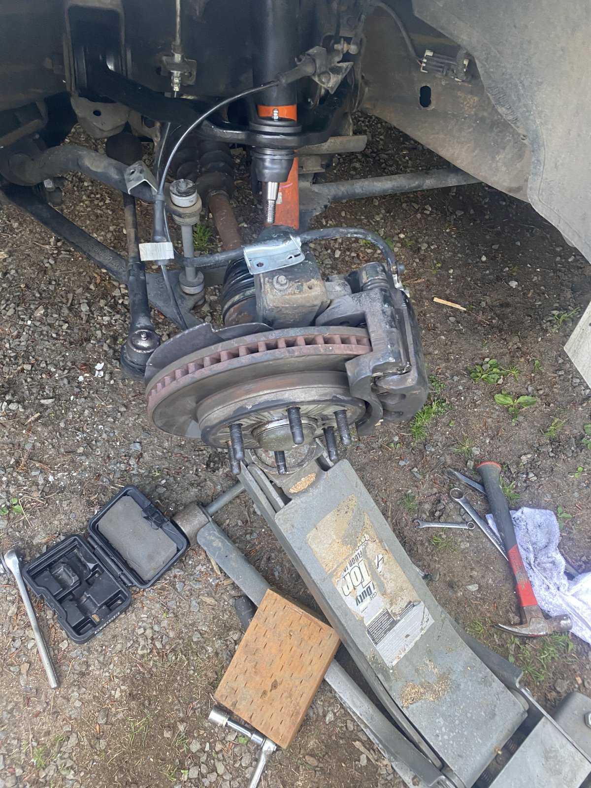

Can’t angle wheel knuckle enough to get upper control arm on
Shtiv
Aug 13, 2020
100
40
Seattle
Any ideas? I’m wondering if it has something to do with the Axel? Thanks?

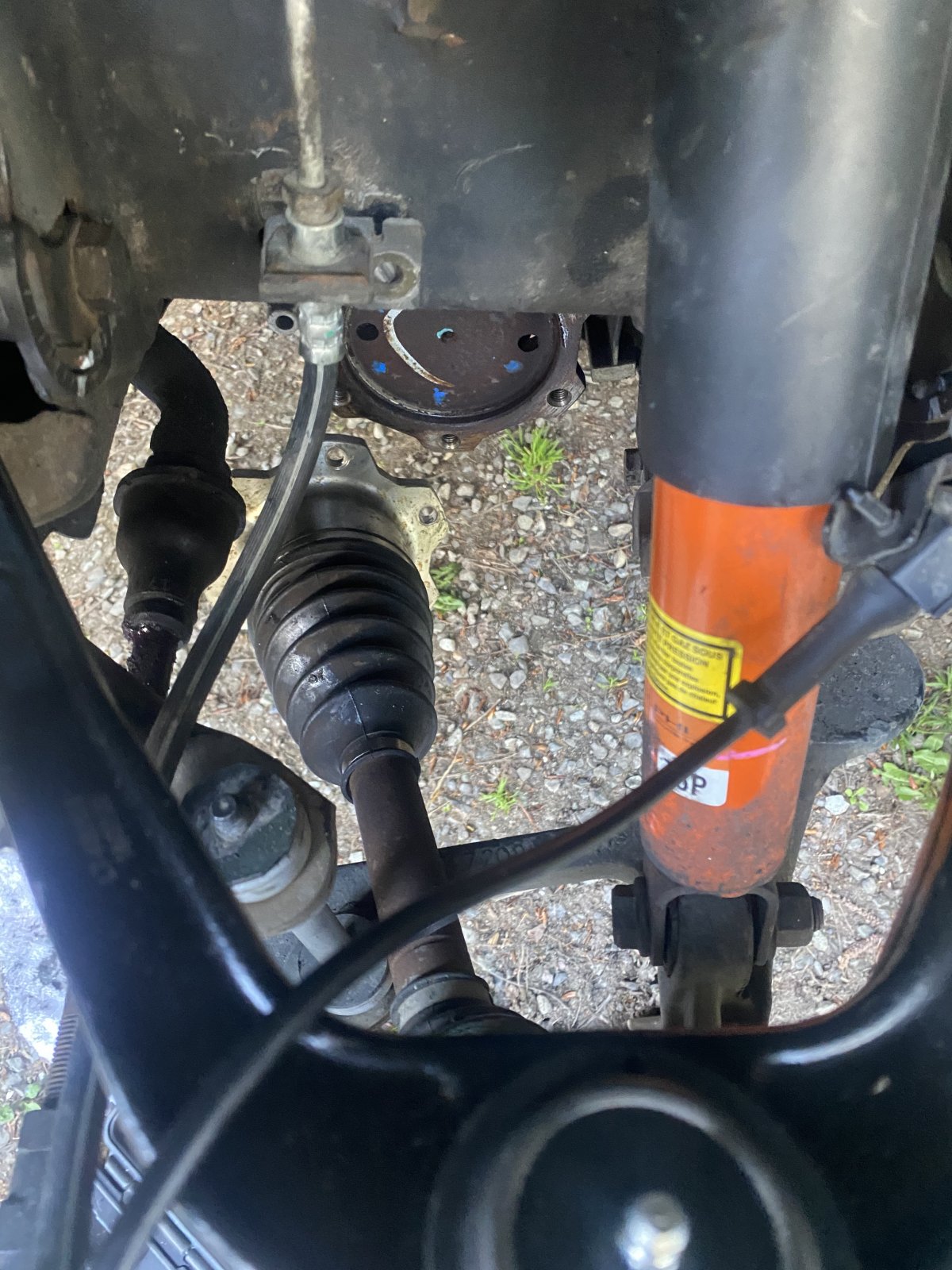

Removed Axel, now can’t get out on....

Apparently the cv acel was bad (brand new) . Replaced it with new, went right on, hopefully that was what making the creaking sounds. Just replaced a few months ago, weird.

New things sometimes are no good. Did you replace the spindle nut at the end of the axle shaft? Don't torque to it where it feels right, torque to specs. Mine is 177 foot pounds, I "think" yours is too.
We’re you able to install everything?
With the CV axle...you need to pull it towards the wheel while putting it into place on the axle shaft.
With the upper control arm...it looks like you should use a ratcheting strap to pull the knuckle towards the Control arm.
Yeah, apparently the CV Axel was bad, (only a few months old). Purchased a new one and everything went right back together without any issues. Shocked the 3-month axel was bad....... We are back up and running, and no creaks anymore.
