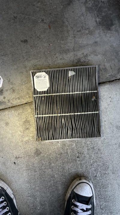

Swapped cabin filter with new one because this is what my cabin filter look like
It’s raining today and I decided to kick the heater on and noticed a notice humm
If I switch to cold hum is there but less bassy
If I turn down air it slows down.

pull out the filter you put in and see if the noise is still present with the filter out, if not then try re adjusting the filter placement
Maybe it’s backwards ?

Damn and I just put all the screws back in last night before the work week started. Ah 5 screws ain’t that big of a deal

if the noise is still there with filter out maybe stick a air hose in there and try blowing it out

There was pine needles and leaves in there and I did use my shop vac as I removed the old one. lol it sounds like a airplane engine but on a subwoofer level and you can’t hear it outside the truck. Yeah when I have a spare minute I’ll pull the glove out and take out filter and see what’s up I have an inspection camera like a endoscope. I just finished the ditch light install

I suspect that some foreign material is still in the fan housing.
