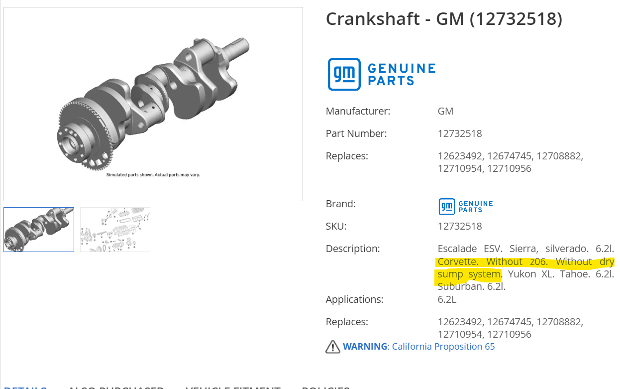

That makes the $5B Tariff hit GM complained about look like a good deal.. incidentally, looks like that "defective" Crankshaft was made "not here" based on the supplier report shared earlier.. ouch.. must be hurting now :boxed:
I'd be interested to find who makes the Corvette crankshaft (part#12705121) which is a different part number but essentially the same thing. The differences are likely attributed to the different transmissions used (Corvette 8-speed has no flexplate, etc, etc,)..
Update: plot thickens
No actually I was partly wrong... likely not related to the transmissions
In fact when I pulled up the defective part # 12710954 (per RockAuto) on GM parts outlet it comes up with an updated part number and also shows some Corvettes use the same part :eek: if this is true (to be confirmed.. maybe call a dealer and get the part #s) why aren't they involved in the recall
