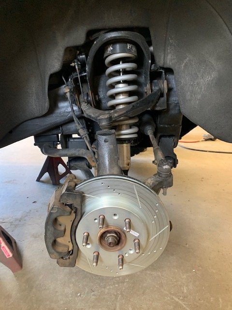

I've been running mine for about 8k miles and performing well so far. I did not purchase the upgraded PowerStop brake calipers when I got the new rotors and pads, but an option as well. Painted options available if you call I think. Noticeable improvement over stock, particularly with my heavier than OE specs wheel/tire setup.

I have the power stop Z36 on my 2006 Yukon XL Denali. I upgraded to the larger gmt900 front calipers and rotors with the drilled and slotted rotors with the Ower stop powder coated calipers and their carbon fiber ceramic pads. I live in the mountains in Southern California and I travel quite often to other larger mountains. The Z36 kit has been on my truck for about a year now and it’s fantastic. Second round of brakes having drilled and slotted rotors and it’s great! The bigger front brakes make a big difference for me going up and down the mountain and the drilled and slotted rotors last quite a bit longer for me than stock rotors. Love the power stop pads too as they shed almost no brake rust whatsoever.
